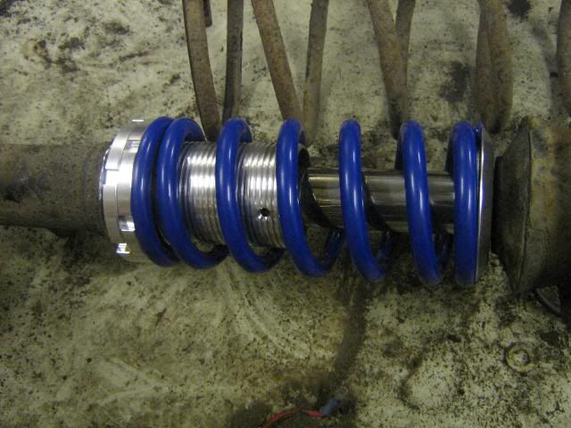

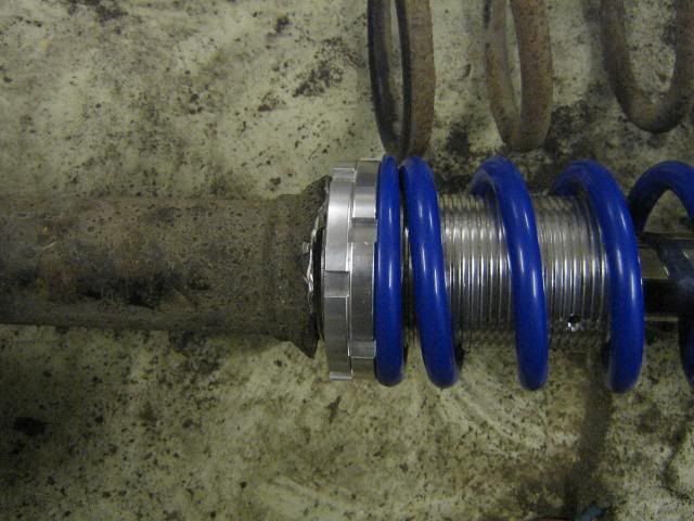

I have had a look and the adjusting bit is all the way down. here are some pics...
front :
rear:
Fri May 13, 2011 5:14 pm
The rear is on max height..
Front is low as it can go. They are not proper coilovers, so you will not get as low with them.

hang on a second is it because at the front your meant to cut off the bit of the insert at the top so it looks like this :

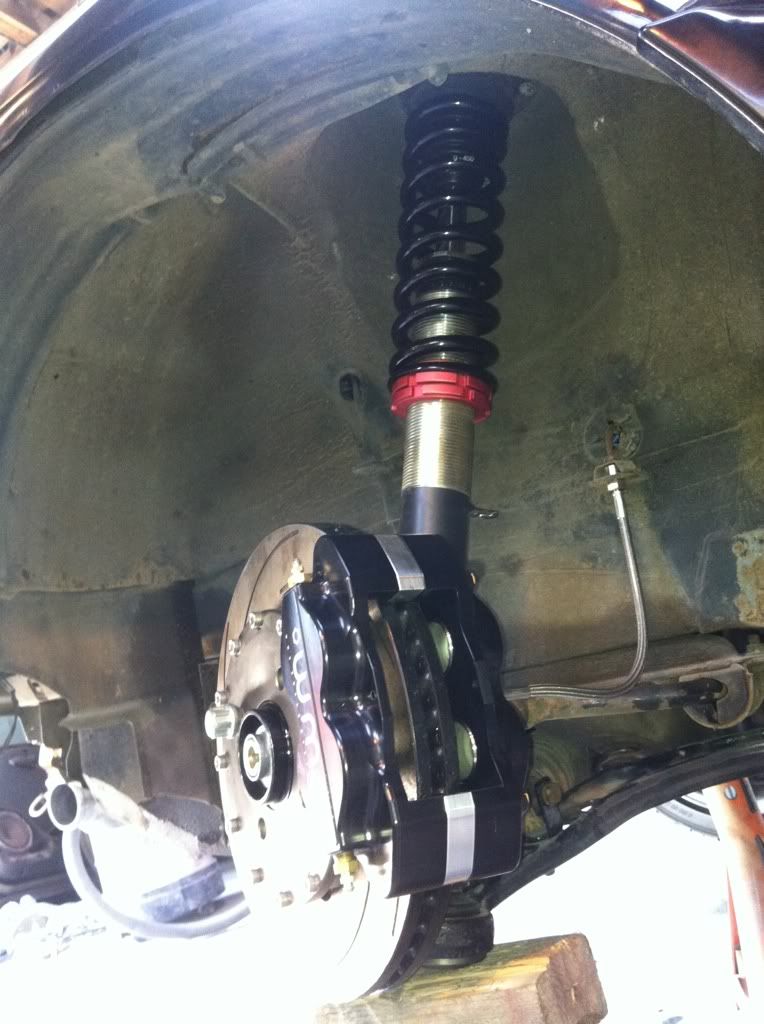

fabsp wrote:hang on a second is it because at the front your meant to cut off the bit of the insert at the top so it looks like this :
thats a proper coilover set up not the hight adjustable ones that youve got ive got proper coilovers on mine all i can think of is that your springs are proberly oem hight and not lowering springs :?
these are mine proper coilovers

Like Dan has said, Not coil-overs in my opinion for a start.
Just adjustable spring perches.
Probably do have to cut off the original spring perches on the front though as at the moment there looks to be almost no travel in the shock and the spring perches are very far up on the strut compared to ones I have seen that fit ontop of the original spring perch.

those arent proper coilovers though there the same sort of thing that I have but the guy who installed them cut off the top bit of the shock housing (the round bit below the adjusting bit) and then slipped the shock in put the rest on top.
Although it sounds quite strange to have to cut these kind of things to me that does kind of make sence to my problem as if that bit is cut off the car will sit a good 60-70mm lower...

Just because those other ones are DIY doesn't make them non coilovers.

fabsp wrote: Okay so basically your saying the blue ones are "proper" coilovers aswell and I cant replicate what he did?
You can replicate what the blue ones are.
But it's a case of taking the origional spring perch off, and sliding the threaded bar down to where the ABS clip is and welding it, and buying some proper coilover springs , cheapest from Faulkner springs,and getting the spring rates right too.

What discs are those Ross?

Just at a glance it looks like the perch has been fitted upside down, that is probably why they wont lower any more, makes sense to me looking at your picture.......hope this helps :)

yeh the height adjusting bit just seams to be sitting a lot higher then it should be and thats whats making me think cutting off the round perch will make it sit where its supposed to. So if I did this would the adjuster have to be welded to the shock housing? or would it sit on there if i left a tiny bit of it at the bottom like this :
cheers for the help really appreciate it
Fri May 13, 2011 11:05 pm
That's wrong, there is no way you're going to lower the car with the adjuster there.
You need to grind off whats left of the perch, and weld the threaded bar lower down, just above the little bracket.

okay so the perch has to be completely cut off up to the point where theres a small rivot/bump
and then the adjuster welded to that...
Sat May 14, 2011 12:06 am
Yes, clean off so you can slide the adjuster down and weld it.
