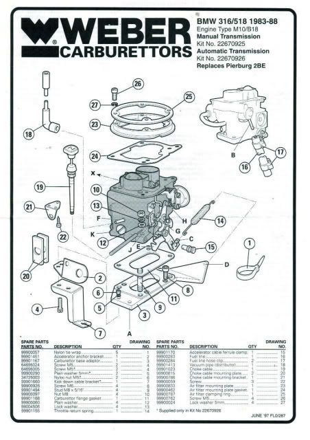

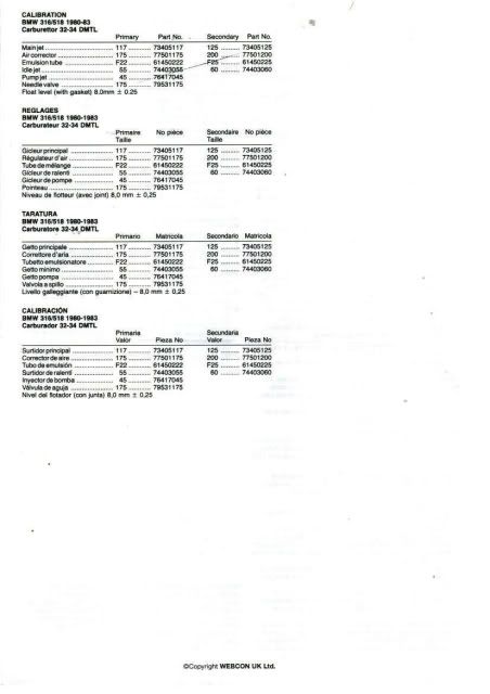

I needed this and have seen other requests come up a few times, so here's the official weber instructions that come with their carb most commonly used to replace the pierburg on the E30 M10.
Courtesy of a very helpful chap at Weber.
I think the original uncompressed images - which I still have - were a bit more legible. If I can work out how to use the wiki I'll stick em in.
I don't know why the last two are smaller :o:
Hope this helps.
