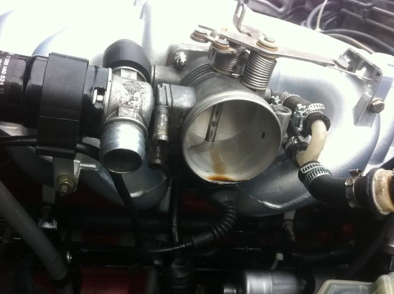

Been doing a bit of snooping around my engine trying to solve a stuttering issue and I have found that I have oil in my throttle body. I know its normal to have a little bit.
As far as I can tell oil vapor comes from the breather in the cam cover up the rubber hose and into the side of the throttle body where the engine will ingest it and effectively recycle it through the normal combustion process.
But I seem to be getting a excessive amount of this vapor.
The result is this oil then runs down the rubber boot throught the AFM and into the air filter.
Thoughts as to why?
Its a new engine with about 800 miles on it.
Mike

Don't like to worry you Mike, but that was why I binned my last 2.7. It was "blowing-by". The oil is forced through the breather(s) by excess crankcase pressure due to piston rings not sealing against the bore wall(s) correctly.
AFAIK (and I'm sure someone will put me right if this is incorrect) there shouldn't be any oil in the inlet tract.

the m20's by design will try to reburn/recycle some of the oil, most m20's i have seen have traces of oil/muck in the throttle bodies and pipes.
did you replace all the breather pipes etc with the new engine?
keep your eye on it but it could just need a few more miles to settle in and run correctly

Engines not bedded in yet IMO, anothing to worry about unless you've got excessive oil consumption and blue smoke in the exhaust.
New style M54 b30's are renound for using oil circa 1L per 1000miles or so. The engines low down torque means that people don't need to rev them, which in turn means they aren't being revved high enough to bed the rings in.

That's interesting Steve. The only time I've ever had a problem with oil in the inlet tract (or the TPS, come to that) on any of my 3 M20s was when I had the shagged bore in the first 2.7.
2.0 was bone-dry even at 170k
Current 2.7 is dry, but then again it's only done 9k since the rebuild.

M54 burn oil due to the bore coating, all modern engines do it to reduce friction and increase economy and performance, this is not the same as mikes m20. As above I would clean the pipes and monitor the oil level.

My M20B20 does this same thing too, but the oil level hasn't dropped noticeably in the past year (it's due a fluid change.) The TPS was filled with gunk when I got it, but I've since drilled a hole to let the oil drain out, as per Brian's instructions.
Seems oil in the TB is a common situation, and doesn't signify imminent engine death or anything of that ilk.

Check that the space above the plate fixed to the underside of the rocker cover isn't full of sludge. If this area can't drain properly, it'll encourage oil to flow along the vent into the TB.

Looks just like mine (thought maybe yours has more?)
The space under that plate in the rocker cover is very hard to get to. Has anyone drilled out the rivets to clean it? How did you re-fasten it? Or do you need solvent (what kind?) and maybe some pressure?

The plate beneath the breather on the rocker cover is all cleaned out as I socked it in a chemical for a couple of days to clean the sludge out then tested it with running water... All ok there.
I have just switched over to full synthetic as everything I have read tells me the engine should be ran in by now, might swap back to mineral and see if this changes anything...
