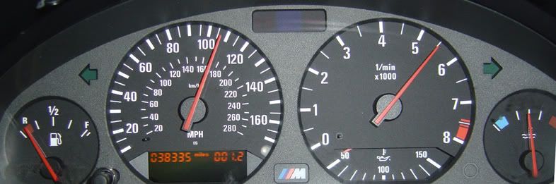

It could have anything in, all the open or LSD large case crown wheel/pinion and LSD units are interchangable.My differential still has the standard 3.something big case and all the new bits were built into it so I can't tell by looking at it or the tag.
They're not weak at all, I know of a guy using a 370 BHP M Coupe race car that uses a 4.45 for a couple of circuits. I've severly abused mine without any problems at all. (Standing starts/donuts in 2nd/3rd gear.)Not as great if it is weaker, although I'm not putting big power through it and I stay away from hard launches and stuff, the only racing I do from a standing start is on gravel and I don't go for a super quick start so it's not that hard on the diff. I hope.
Prolonged heat is the enemy for these diffs, but anything lower geared than a 3.9 isn't quite as strong as the others.
3.2 Evo in a Compact.Is that an E36 M3?
Mine was sat on a ramp with no wheels on when I took the pic, I was testing the speedo reading.I think my 323i would need a big straight to get to 170km/h, and I don't think it would go much further.
