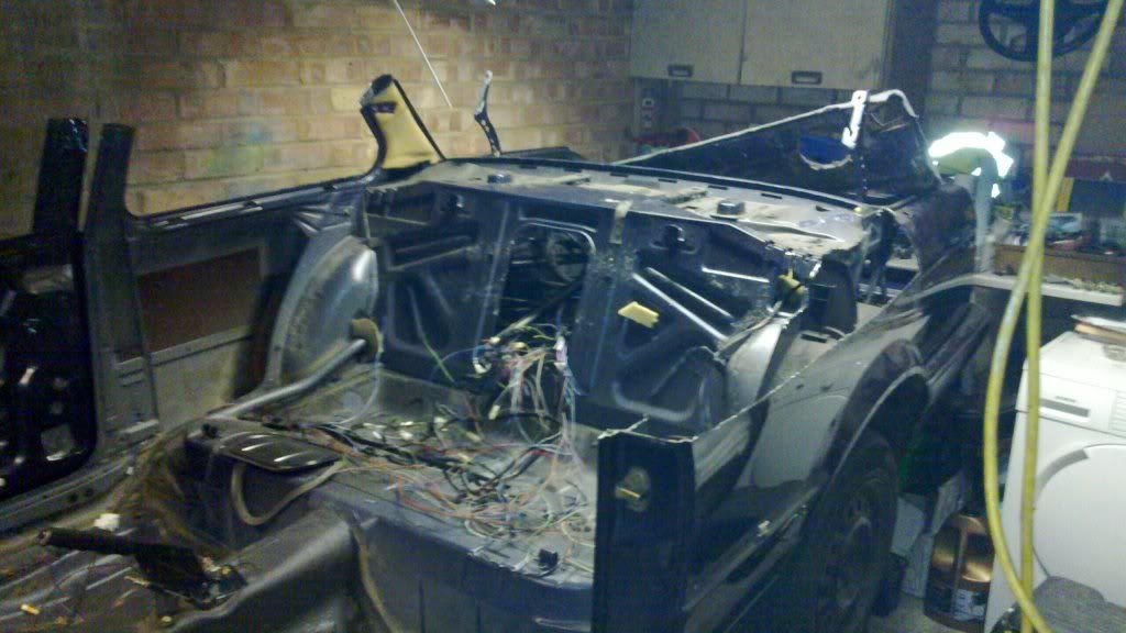

I'll get some pics of the one I'm fraggingDuke137 wrote:
Thanks mate, When your breaking a car you can never "remove more than you need to"
318i Touring
You ever had this problem Jason?
Possibly, but only a skilled welder with far too much time on their hands.... Actually it was only good for fragging really, once I removed a few parts and started digging deep. Shame cos I hate the fact E30 numbers are dwindling.rmurphy520 wrote:ahhh right. Could she not be saved?
I just didn't have the time / extra money for the extra work it would have entailed.
It's dead now anyway its not a complete shell anymore....

just wish I had more space. only have 600mm down one side of the car the other is 50mm, rear bumper touching and 300mm along the front.
And as for roof space........
I'll go and get a pic
318i Touring

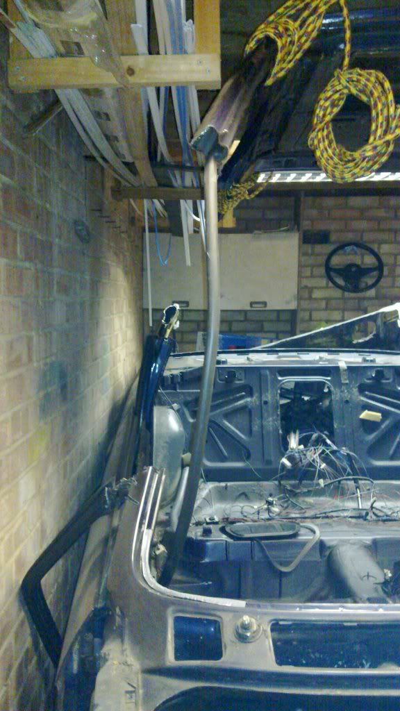

TouringTash
- Posts: 3804
- Joined: Mon Jun 28, 2010 11:00 pm
- Location: Kent
yep the door got it
if anyone knows of a spare barn (with power) empty in kent.
nudge, nudge, wink, wink. you know who you are, you mini fettler.
318i Touring

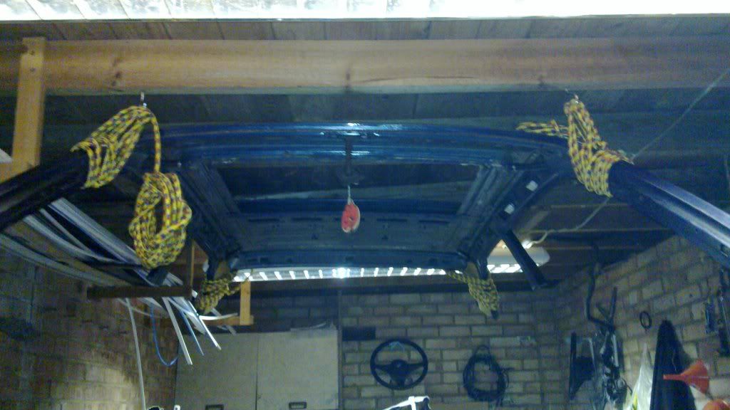

TouringTash
- Posts: 3804
- Location: Kent
got told that the cassette had been changed as its been painted blue and sealed in place. No rust anywhere, some one must have a solid car with a rusty sunroof area.
Can even put someone in need with a very good bodyshop guy.
Or am I just being
Or am I just being
318i Touring

Ha, i thought i was tight for space.TouringTash wrote:
Chop that across the floor and stand it on the rear bumper.
Duke, make sure you get the breather pipe out the way before you have a go with a hammer.
There is NO nucleus.
Amazing, panoramic roof touring haha
To be honest Jay I'd just weigh it in mate!
It's a shame but you'll have that "hanging around" for 10 years and no one will want to pay you much for it anyway...
By the way, how the hell do you manage to work on it ?
