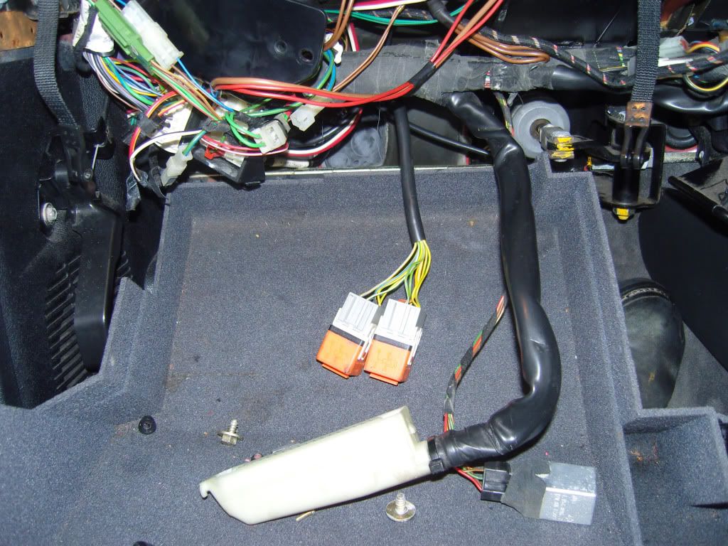

I don't have a picture, but the relay is by itself, very near the front of the opening of the top part of the glove box, clipped on with its integral clip. Fairly obvious if you have a look.
Either silver coloured, or black if my memory serves me right.
You may have to allow the glove box liner to drop down to see it, but I can't actually remember
