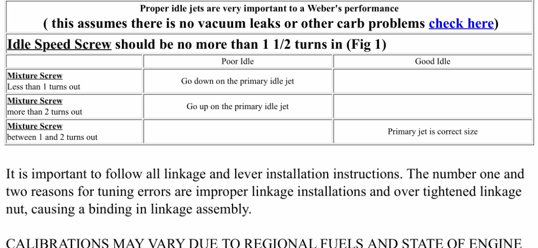

I adjusted my mixture screw with a air/fuel meter to a co% of 0,5% . It was at 5% , mixture was too rich... Now it starts perfectly and without pushing gas pedal. It also consumes less fuel now , yesterday i drove 210km with 15 litres of fuel (80% of freeway at 120km/h , 20 % smaller roads at 70 - 90 km/h)

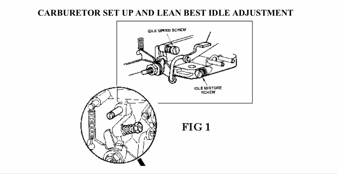

Where is the air/fuel screw? I can only seem to see the idle screw!
Similar issue, and my sparkies are completely black! So defo running rich.
