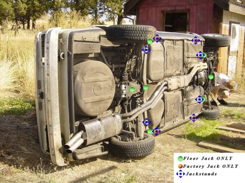

You'll be wanting this essential picture saved to your computer!
Don't know who made it, but stuff like this is bloody handy!

As you can see from that piccie,the 'wheel changing'points are fine for axle stands.
When I use them,I cut some scrap plywood to fit either side of the cill seam so that the wieght of the car is taken on the cill,not the seam.
