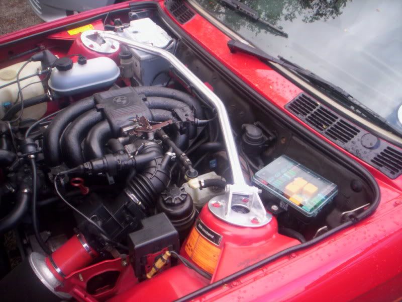

just been giving mine bit of a clean, gunk/tfr cleaner, wirewool and a brush, only done 1 side quick
and for paint work, i use any car polish and rag thats laying about
