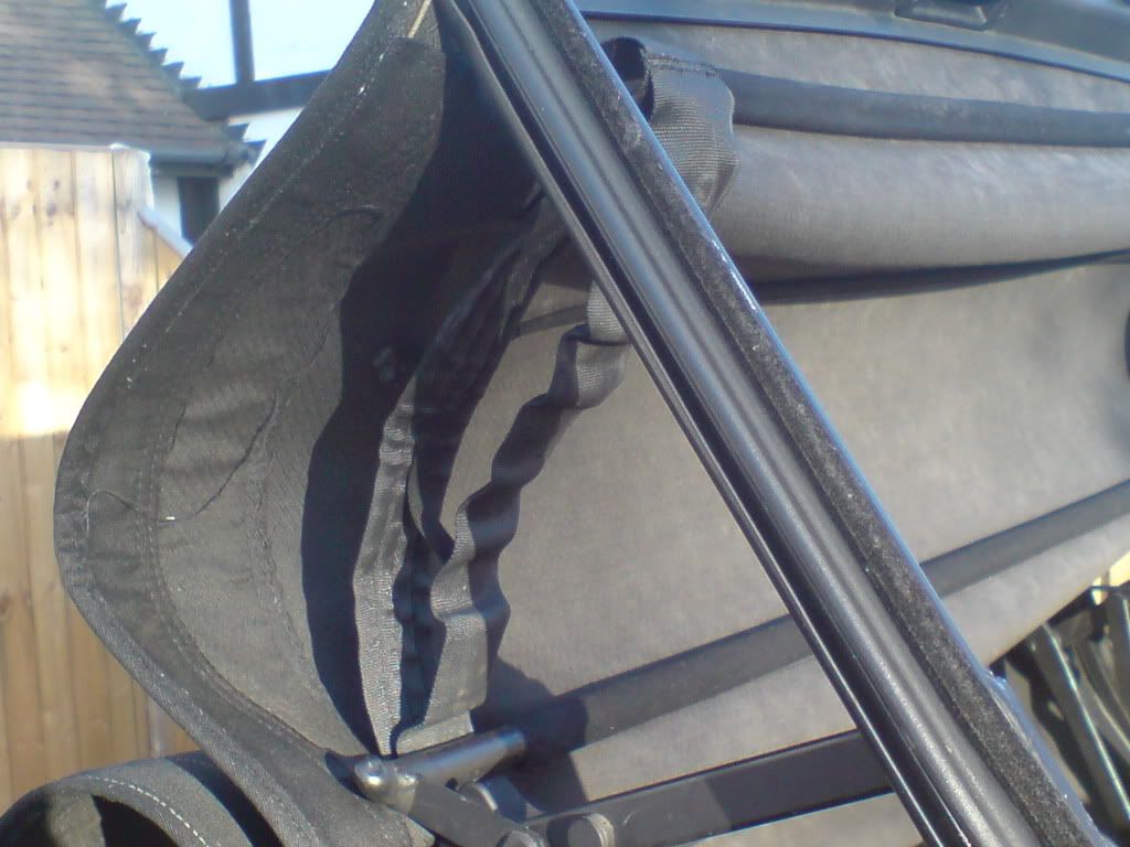

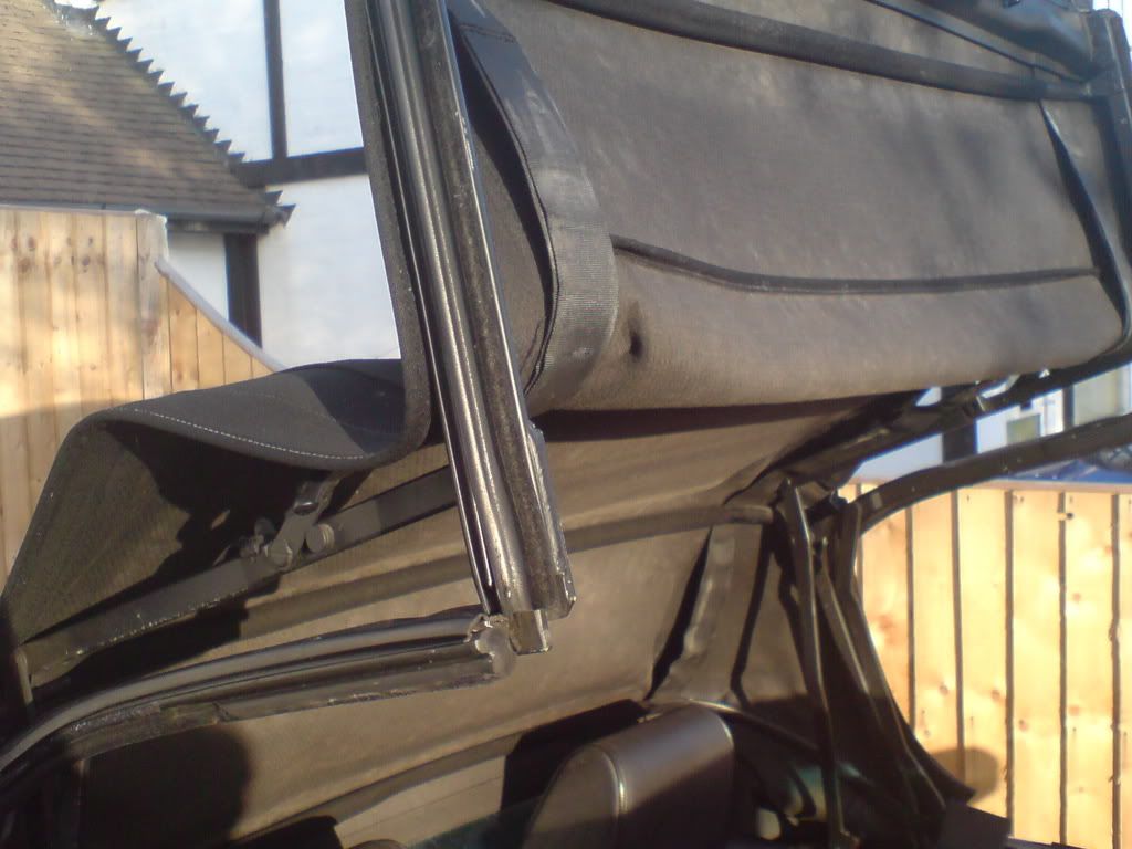

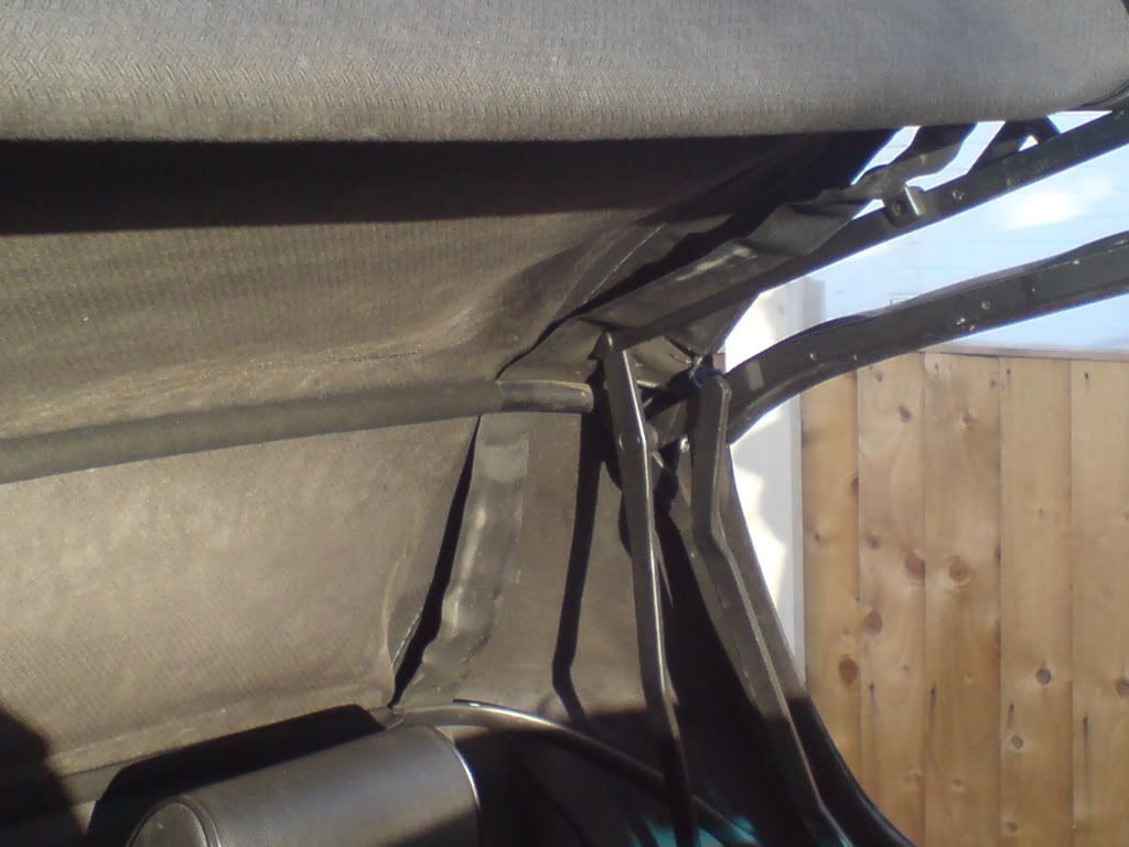

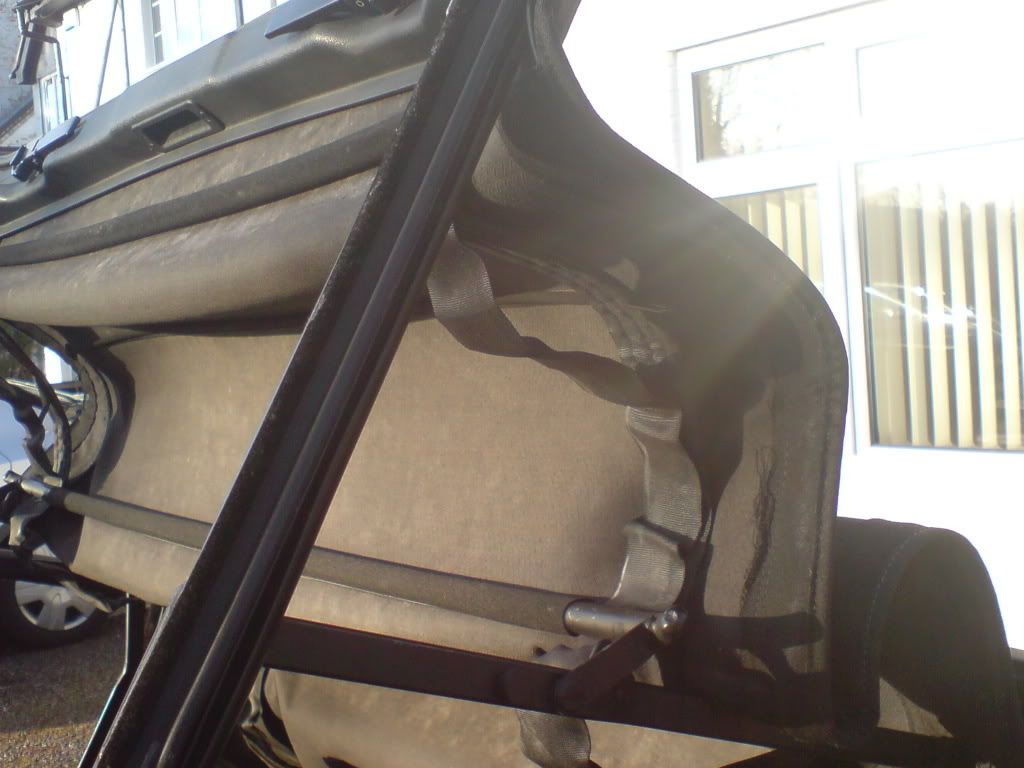

Here are some pic's of mine:

on the last 2 pics.. did you do that by hand? coz thats how its suppose to be ! at that stage, i have to push that bar back and tuck the fabric back into that postion too !
- Posts: 22478
- Location: Derby Massive!!
Yeah i did that by hand, didn't know you had to do that, thought it did that automatically
