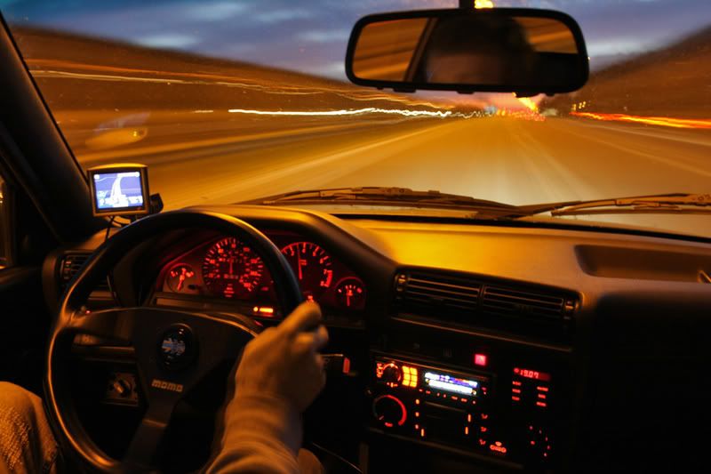

just saw this photo:
http://i49.photobucket.com/albums/f290/ ... G_8142.jpg
and noticed working heater control bulbs, mine doesn't work.
How to change these without taking apart whole dash :roll:

One is easy to get at in a RH drive car with an analogue clock. Simply remove the clock from the front, and the bulb is immediately below it.
On a LH drive car you can probably get at it removing the radio and its cage.
The second bulb is level with the bottom of the fan control, but a little to the right, and with the back end of the bulb angled 45 degrees to the right.

cro320 wrote:just saw this photo:
On this pic the head light adjustment switch should be lit up :mad:
