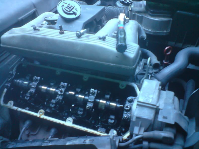

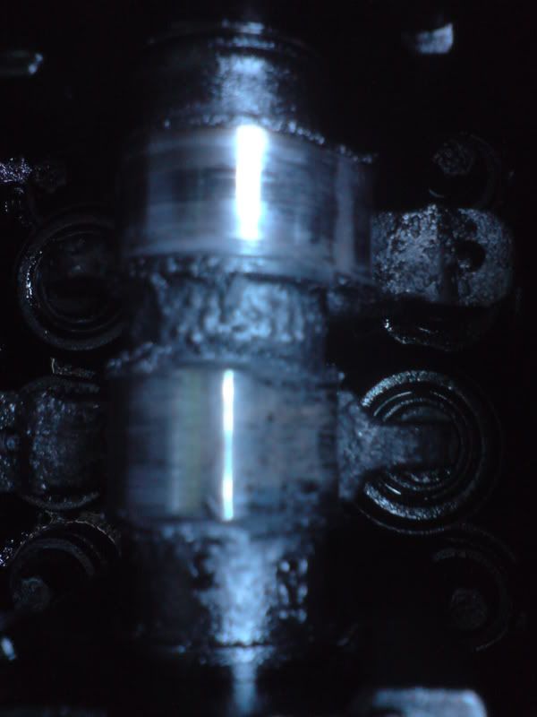

just drained the oil and swapped over the filter, took the rocker cover of the find that both the inlet and outlet lobes on piston one of the cam are really badly worn and covered in swaf and bits of cam.
see pics...
hopefully this will help other people with a ticking 318!

looks like thats had lack of oil was the spray bar blocked???
that is bad compeared to even mine 8O
i didn't even see your vid when i posted :o:
when you put it back together tighten up the fan belt :lol:

gutted! is there anyway the car was clocked? or the engine switched? never heard an e30 run so rough (and I have had about a dozen!)
some tapping is normal for m40's but thats no tapping!

the spray bar was blocked yeah, ive cleaned it out now.
no i dont think the car was clocked the numbers look all straight and inline
the story is the original owner was a doctor, and he went a bit barmy so the car sat in his garage 8-10 years! and the guy before me had it at 35k and has basically trashed it upto 75k when i got it!..
hey ho
