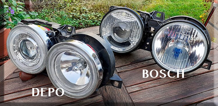

OK, so I decided rather than drive around in the dark looking for white walls and taking photo's which might represent some kind of
result but are always kind of random I thought I'd test a small number of H1 sources. As you can read in previous posts fitting the most expensive LED
was also the most laborious - but maybe worth the effort if the resulting light output performed well.
I picked a standard H1 - they are arround a couple of euros each on Amazon - a cheap LED H1 from Ebay which boasted massive power output !! An Osram Nightbreaker
Laser new generation and finally the Bettercarlighting.com 110 euro LED (pair )
I also have available two lamp housings - one is the original Bosch Smiley set and the other a modern Depo equivalent (ish) The idea was to test all the light sources in both luminaires
to give a general comparison.
I set up a lux meter set in the "hottest" part of the beam at a distance of 1 meter from the the vehicle. The ambient light in the garage registered as 2 "lux" at all times.
As the Depo and Bosch lamps produce different beam centres I adjusted the position of the sensor to find the highest ouput from each bulb on each of the lamps.
This is probably not the most scientific way to do this but the idea of driving around after fitting each test lamp to take photo's felt a bit daft and open to large errors and interpretation.
I'm also aware that this doesn't really address the all important "Beam Pattern" question.
Results stacked up like this:
DEPO.
Cheap LED 5 lux
Standard H1 130 lux
BCL LED 69 lux
Laser H1 216 lux
BOSCH SMILEY.
Cheap LED 4 lux
Standard H1 116 lux
BCL LED 93 lux
Laser 186 lux
Not too clear why the BCL LED produced such poor results in the Depo - maybe the orientation of the LED chips doesn't suit them. The cheap H1 LED was incredibly poor - almost no light output at a 1 metre distance from the lamp!
I'm now running the Depo's with the Osram Lasers for both Dip and Hi beam - and they are very very strong - the light from the BCL LED's is the same color as the Lasers but just doesn't pack the punch you need, especially for the cost.
This is what I used for the test.
I also tried some cheap H3 foglamp LEDs - equally useless - now have Laser H3's installed here as well
Paul :-)
