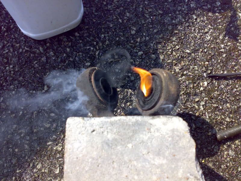

and top tip on the freezing of bushes - that's gonna save me some B,S & T in the future :)

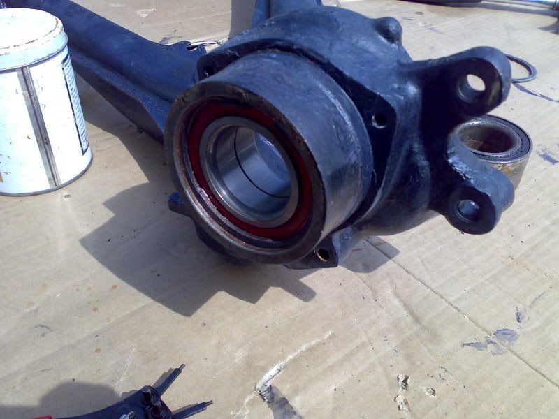

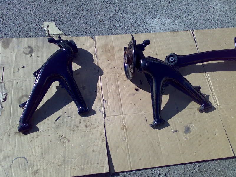

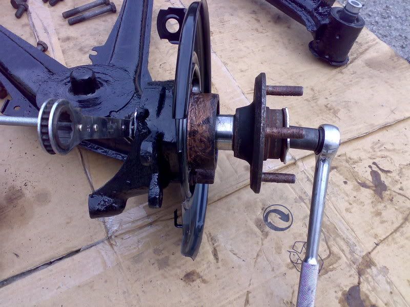

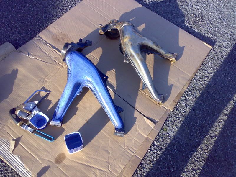

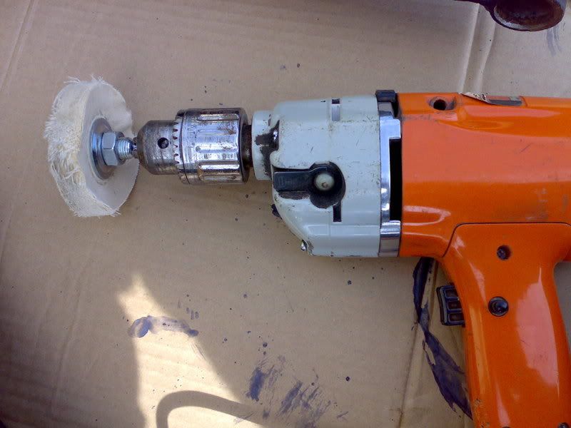

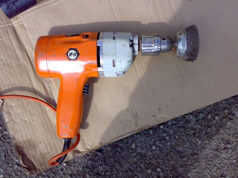

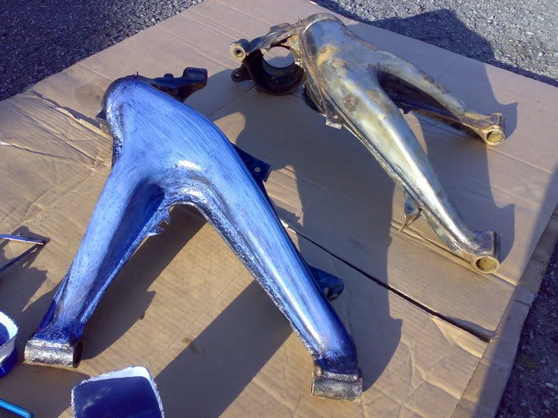

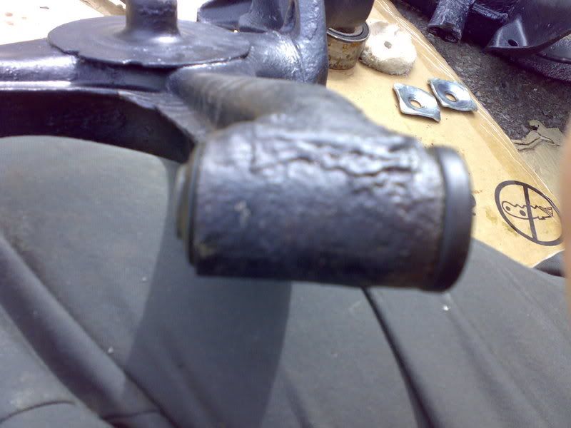

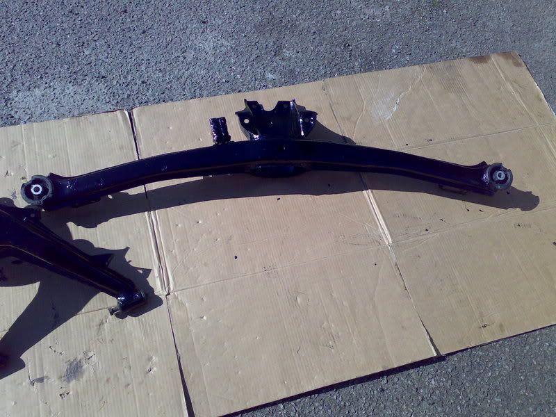

After much scraping of rust with 70's drill the trailing arms look like this now having their Bilt hummer blue coat!
70's B&D drill retro..
Dual wheel carriers -------195litre Fuel Tank
London 2 Cape Town
www.Overlandinthesun.com
Gwynleym10
Posts: 3650
Location: London/Cymru
Wed Aug 22, 2007 10:01 pm

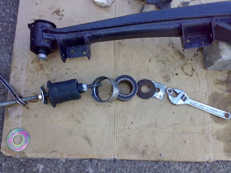

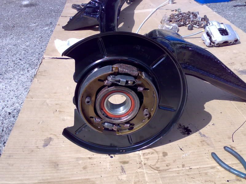

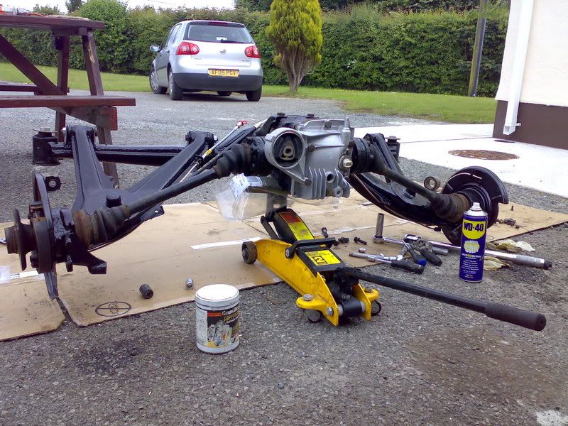

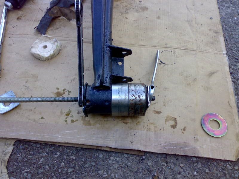

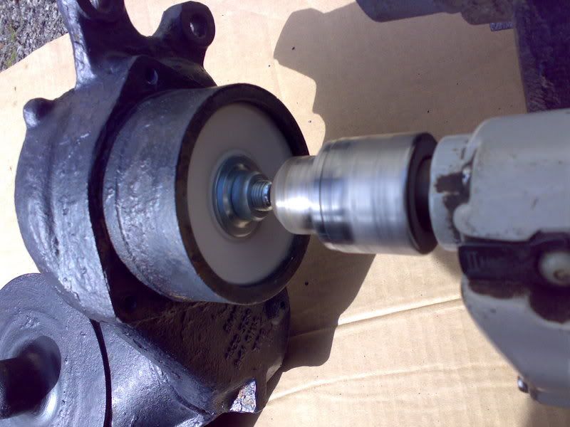

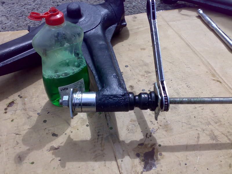

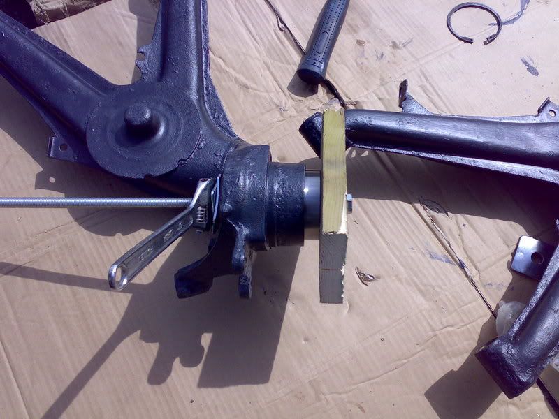

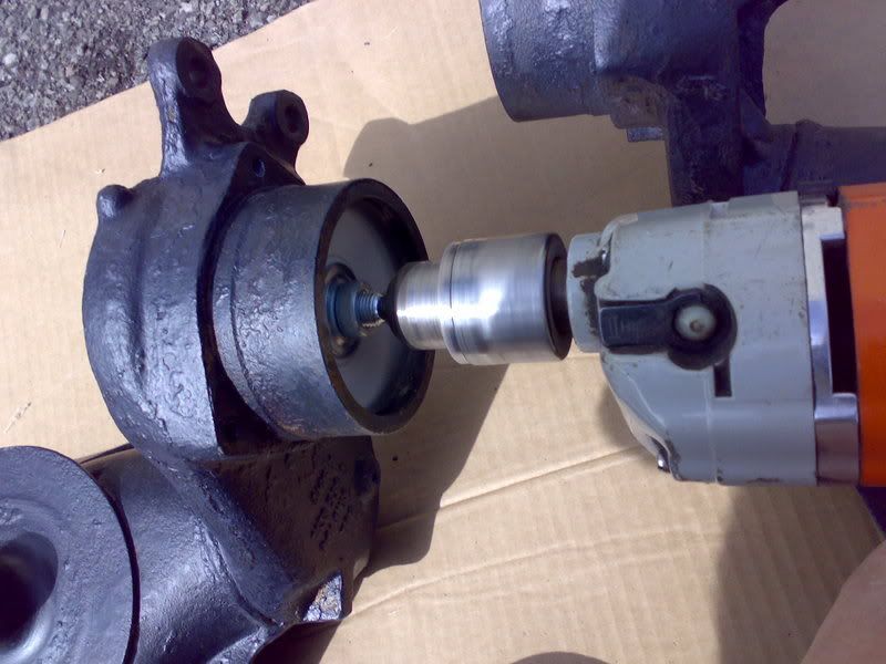

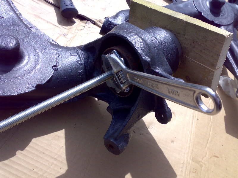

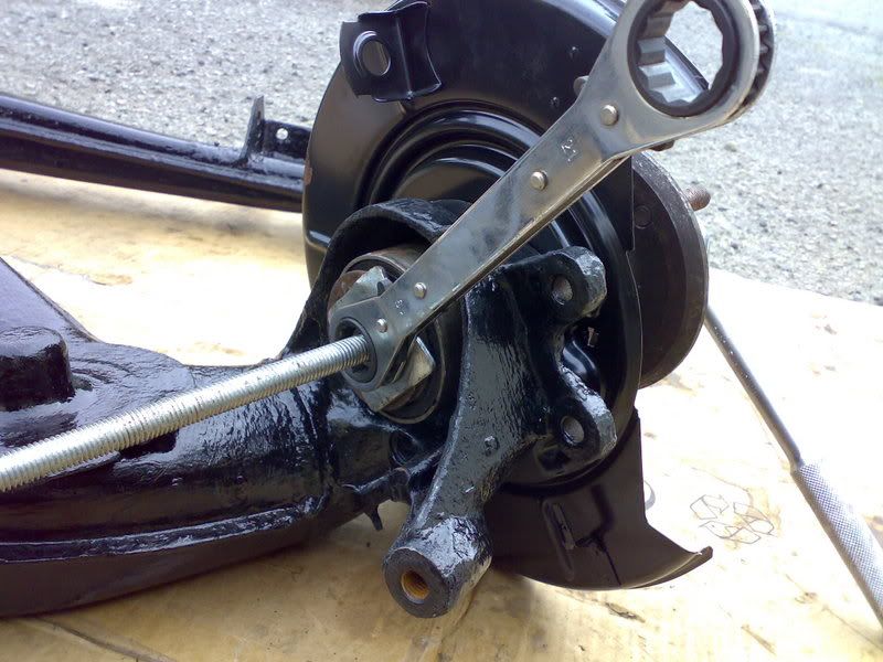

After making sure all the surface were clean and free from paint I started the reassembly of the trailing arms.
Winding the hubs in
Now with the big circlip in!
Winding the trailing arms bushes in - lots of fairy!

I then gave them a couple of coats of hammerite and fitted new backing plates.
I then did the same kinda thing with the rear subframe bushes. As you will notice I'm using old hubs as spacers.
And gave it some hammerite

Hand brake...
Winding the flange in...

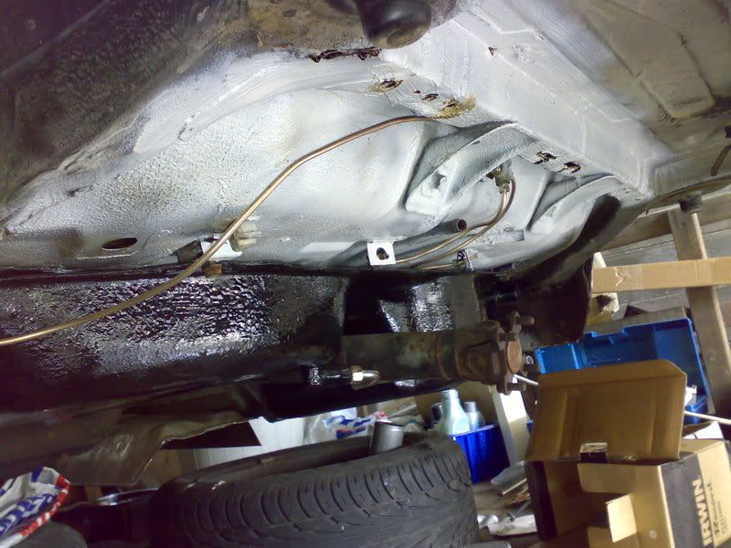

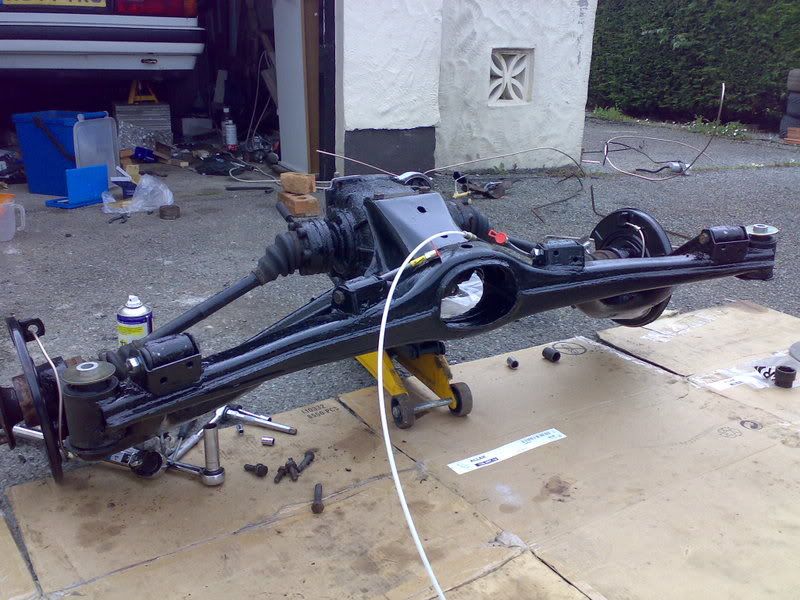

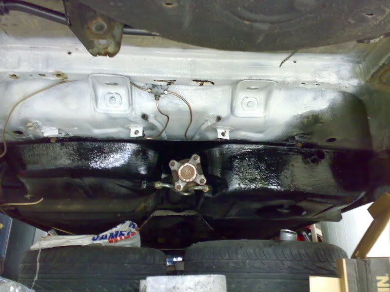

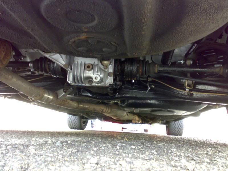

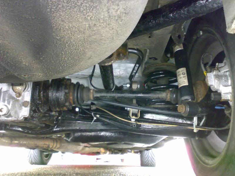

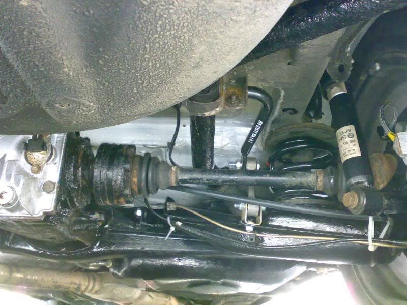

New fuel lines / tank and brake pipes in..
I then decided to fit as much as the rear as possible so I could work on the front..
wibbly wobbly

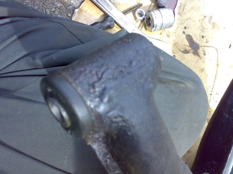

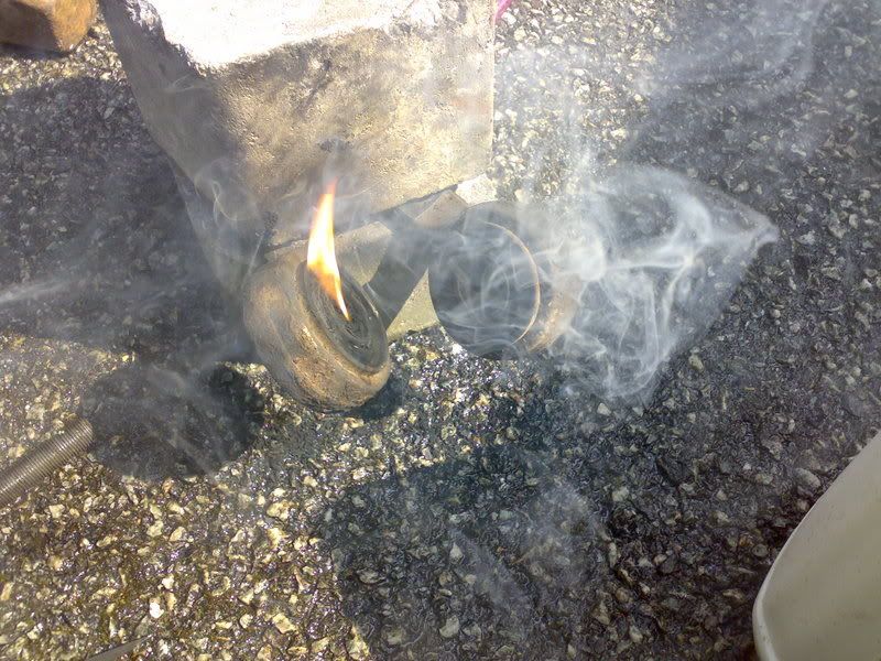

Now the front..
burn burn burn

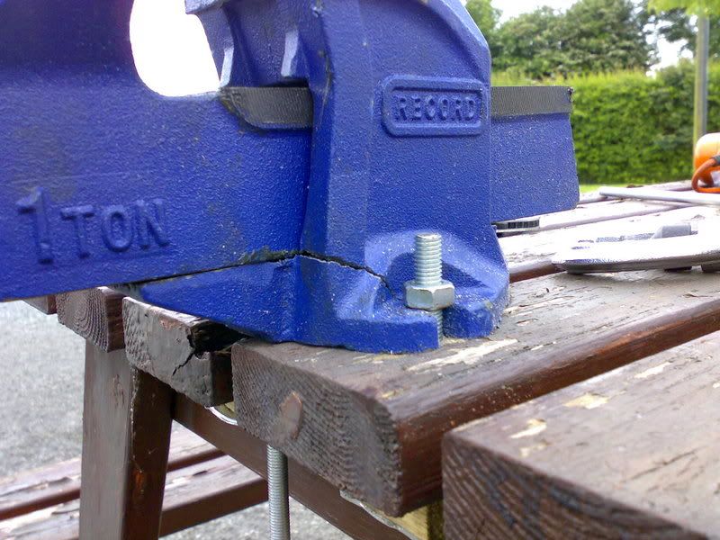

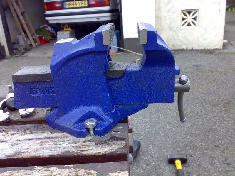

Whilst trying to put new bushes in the lollipops I broke my vice... ooops!
Nice girl at B&Q gave me another one, I think she was impressed by my strength of snapping metal!
Always use a picnic table as a work bench! - you can sit down.

Not surprised TBH the CAB needs a 10 ton press where as that vice is only 1 :eek:

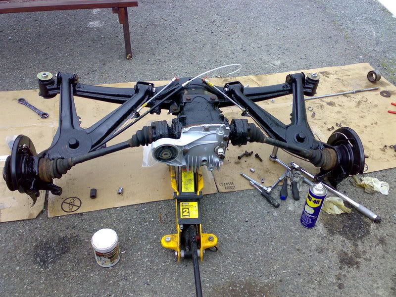

Rear all back together and back on the floor
Pictures arn't great..
I think I need new driveshafts but only when I can afford a LSD as well....

Demlotcrew wrote:Not surprised TBH the CAB needs a 10 ton press where as that vice is only 1 :eek:
Good work tho
Thanks!
Yes it wasn't working got a garage to do it in the end. Took me a while to find somewhere to do it - ended up being a cylinder head reconditioning place as they use big presses.

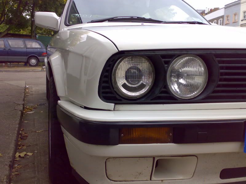

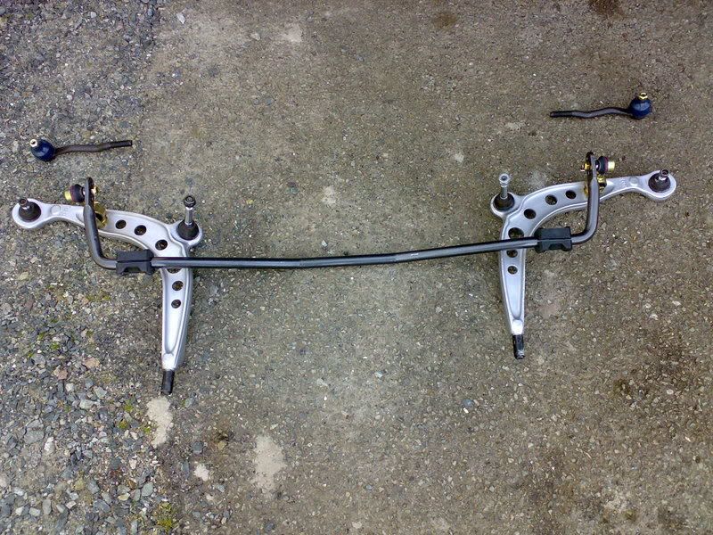

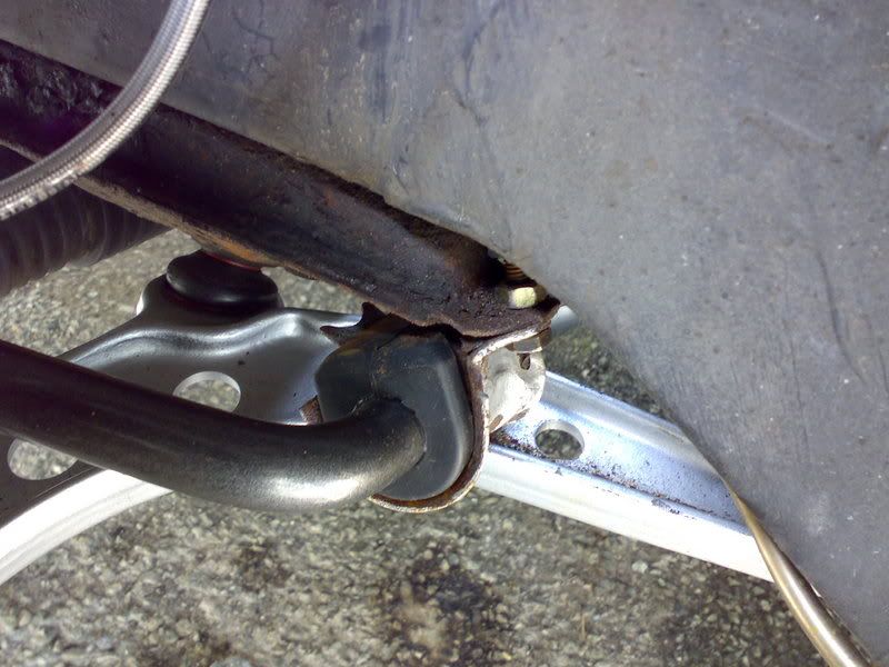

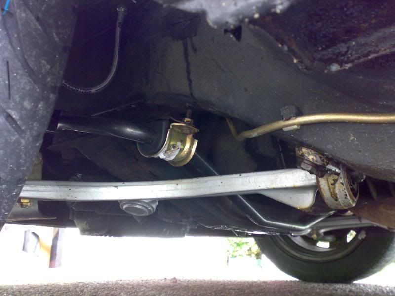

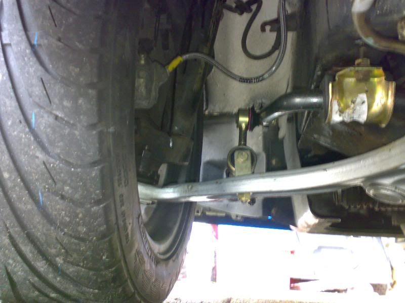

One or two pics of the front - its not that photogenic there!

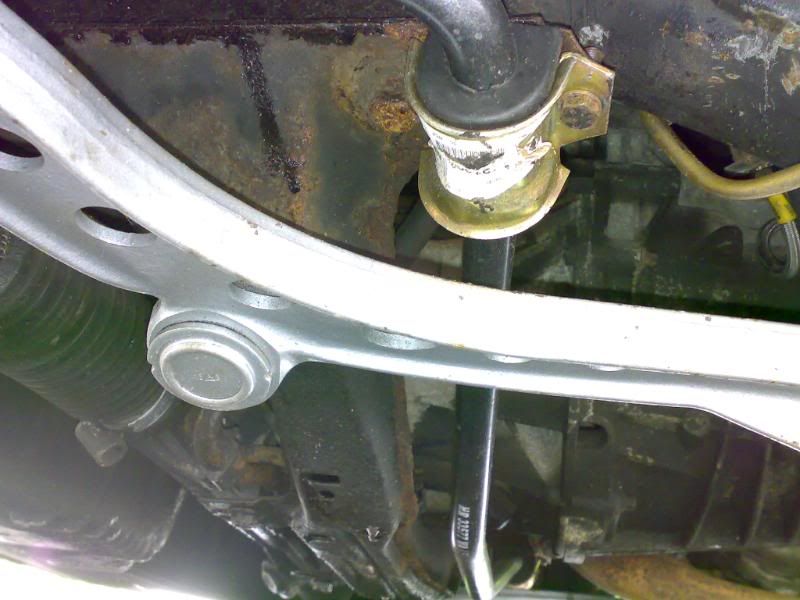

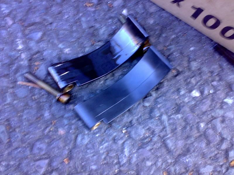

Wan't happy with the H&R ARBS when they did this...
Got new mounts and reduced the size of the bush. I think the bush is the wrong size - can't see how it would have fitted safely.

Demlotcrew
Posts: 13329
Location: East Anglia
Thu Aug 23, 2007 8:38 am
Going by the first pic of the ARB you have fitted the bushes the wrong way round, they are deffo the right size and i have yet found a problem fitting the H&R supplied ones.
HTH
Gwynleym10
Posts: 3650
Thu Aug 23, 2007 7:09 pm
Lol see what you what you mean by the first pic.
Deffo didn't fit them like that, they wouldn't have got anywhere near being fitted the wrong way round - due to the flat bit.
I thought simon13 had issues?

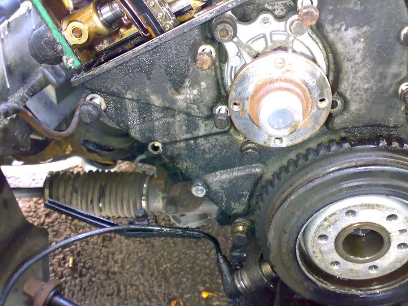

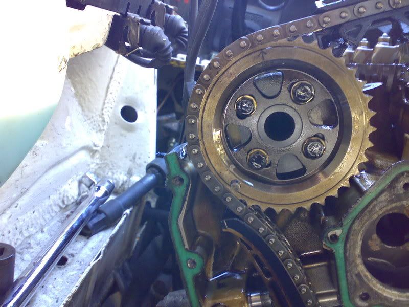

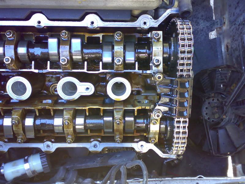

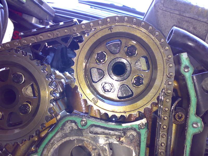

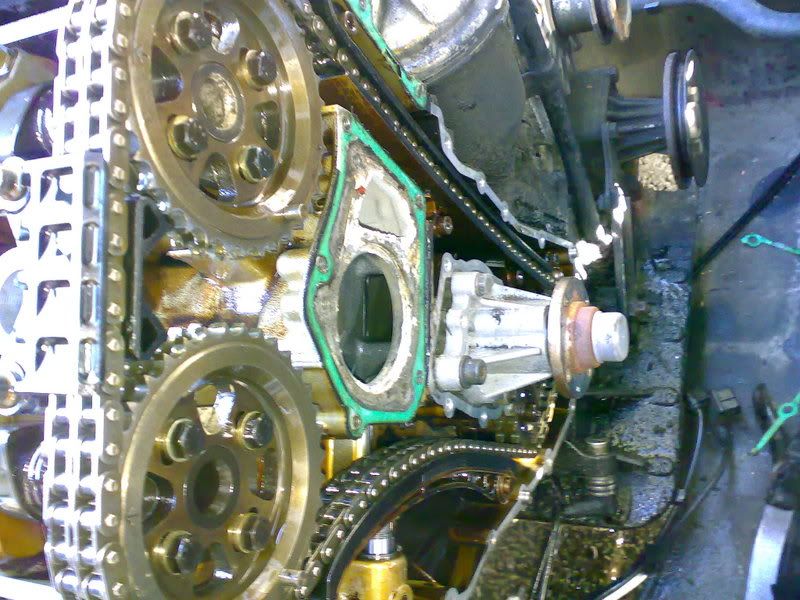

What have I been upto in all this time I hear you all ask? Well still a fair amount of work...

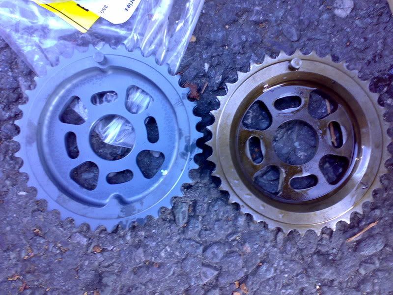

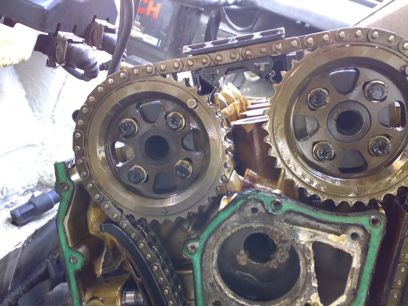

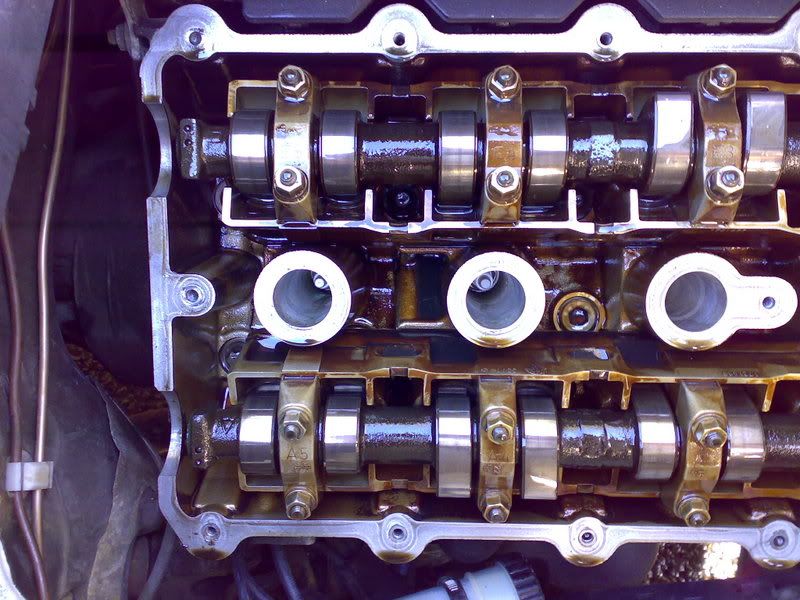

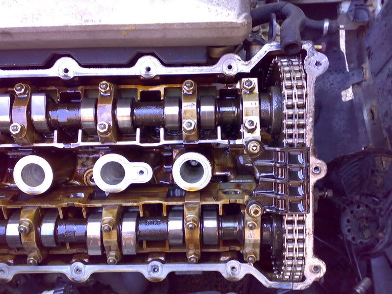

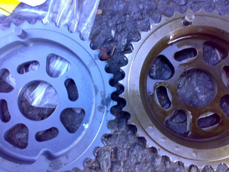

Timing chain was the next major issue. It had been noisy ever since I bought the car, tried replacing tensioner but to no avail. - so it was the whole job.
I hadn't even taken the valve cover off this car, but decided to replace everything (sprockets, chain and guides + gaskets) I didn't see much point just replacing the chain, from my knowledge of mountain bikes - when the chain wears and stretches it wears the sprockets.
I'm not writing a how to as it is all written here;
http://www.esatclear.ie/~bpurcell/318istimingchain.html
This write up is great and it all worked - including using the started to get the crankshaft bolt off (Ok I admit I killed one socket - but I never liked it)
I also didn't use a locking tool - I couldn't afford near enough £100 for one. I used my m40 bit to hold the flywheel though - and just kept and eye on the cams.
Pics
As you can see how worn the sprockets are! (new left old - right)
Lower guide wear
Random engine shots with old chain
After the car is now sooooo much quieter. All the dodgy rattling has gone!
It took me a couple of goes to get the timing right, first it dieseled a bit, then it wouldn't idle perfect. Now it seems to be OK.
Not 100% sure but it feels a little down on power - I do suspect that is lack of noise though!

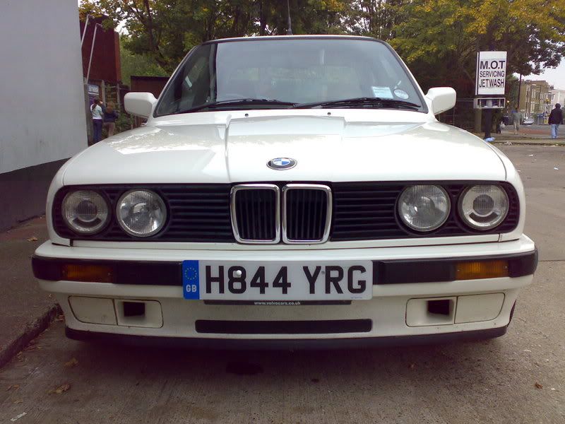

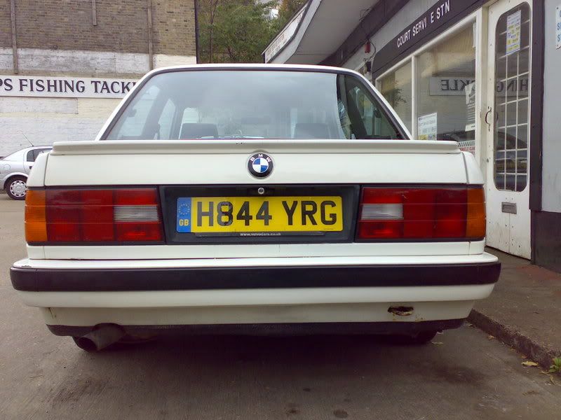

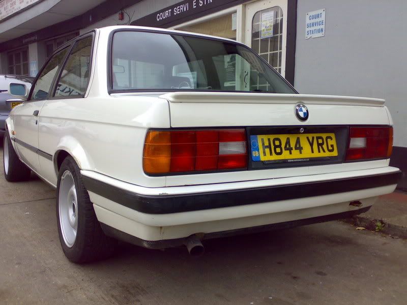

When I came back from France I actually cleaned my car and took some pictures!
It is in OK condition, but I think the bodywork is the next major thing....

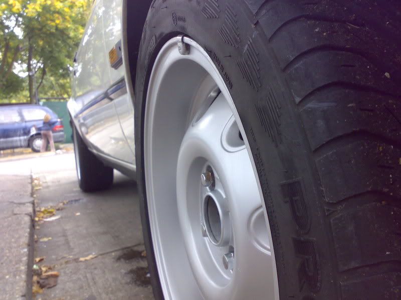

what size are your wheels ?
Gwynleym10

Sat Oct 13, 2007 10:43 am
Hello
Wheels are 15" - I wish they were 16"....

Sat Oct 13, 2007 3:31 pm
cool - and what about width ? I just thought they looked a bit wider, or at least stick out the arches a bit more ?

Sat Oct 13, 2007 11:41 pm
Not 100% sure of width - I can't remember...
They have 205 tyres on them
Fronts have 5mm spacers though

Sun Oct 14, 2007 12:09 am
Gwynleym10 wrote:Not 100% sure of width - I can't remember...
Ahh, right it'll be the spacers that I noticed then.

Oh I have a spare part number 14 in this
http://www.realoem.com/bmw/showparts.do ... g=11&fg=25
I got sold two for some reason... Yours for £45 (cost minus VAT)

Ajay325
Posts: 385
Joined: Sat Feb 03, 2007 11:00 pm
Tue Oct 16, 2007 6:28 pm
i may hold you to your offer as this is a job im seriously considering to do. Are there any parts I could get away with not replacing?
