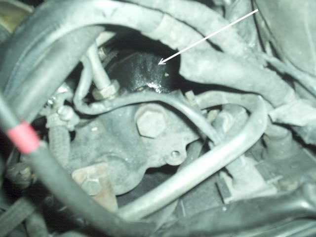

right i hope i describe this right i have a sphere ball system apparently from an M6 and the fluid controls the steering and the brakes (does this sound right), so is it still as easy as you have just said, someone give me a dunce hat please.

Right, lack of knowledge so you have to bare with me on this one Gorilla, right in these pictures below, the bottom right hand corner of both pictures is where the leak is coming from at the top, i believe its coming out of the sphere ball itself, as there is runs of fluid flowing down the sphere ball and more than one, and also there is a little puddle underneath, i defo think this is a job for the mechanic now, everything is going wrong this week

The bottom right is your brake fluid, What sphere ?

i will have to take some more pictures again, where the brake fluid bottle is
(ha ha, my knowledge sucks) just behind or on top of it is this black ball, that just sits there, oh i give up i will never be able to describe it, will have a look on the net for some pictures, if not i will take my ass down to the garage and snap away, give me five.

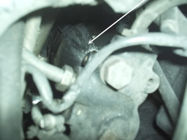

right this is the best i can do, with the pictures. The arrows all point to this black ball that is leaking this red type of fluid
I am thinking it has something to do with the power steering as when i turn left or right the steering is making a slight noise, that i once had long time ago on my Astra GTE convertible but was a lot louder, and ended up with a new rack, sorry but its the best i can do for now, other than that anyone going to the Ace Cafe on monday bring a torch and i can show it to you properly.

I think, very hard to tell from photo, that you are leaking power steering fluid from either your power steering resivior or, what looks like a steering pump ? which makes me think have you an electric power steering pump on this car ?
Noise when turning indicates low fluid in system, keep topping it up, until you rectify the problem.
Looking at your new pictures, you need to have your expansion tank fitted where your washer bottle is and your washer bottle or a replacement that fits, located where your expansion tank is.
It is much to low where it is and will cause major coolant problems and possible hose failures due to hoses splitting under extreme pressure.
