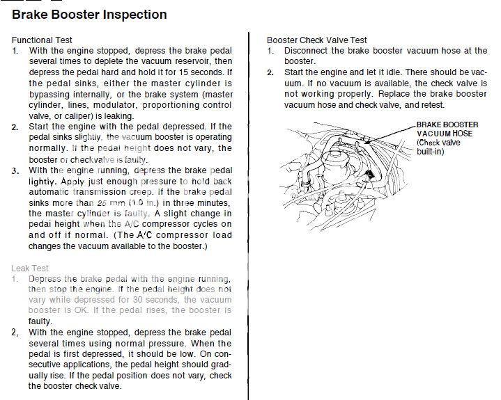

i've found this online
https://i267.photobucket.com/albums/ii3 ... 9241490006
& soon as it's stops raining i'll be back outside trying it.
i'm starting to lose hope with this car as it's really the only thing stopping it from being back on the road despite the fact i've rebuilt the engine (high spec stroker build), gearbox, chassis & bodywork yet this one little bit has stopped me dead in my tracks.
i'll have a look through the bently manual see if that shows anything i could try.

well i've been out & tried the tests in that link & from what i can gather the both the servo & M/C are working as they should.
i'm so so confused right now.
my dad is coming round tomorrow (providing it don't rain) & i'll get him to help me bleed the brakes again just in case there's air still in the system (can't hurt to try).
i really really want to get this sorted as there's 2 local shows i want to take it to next month.
