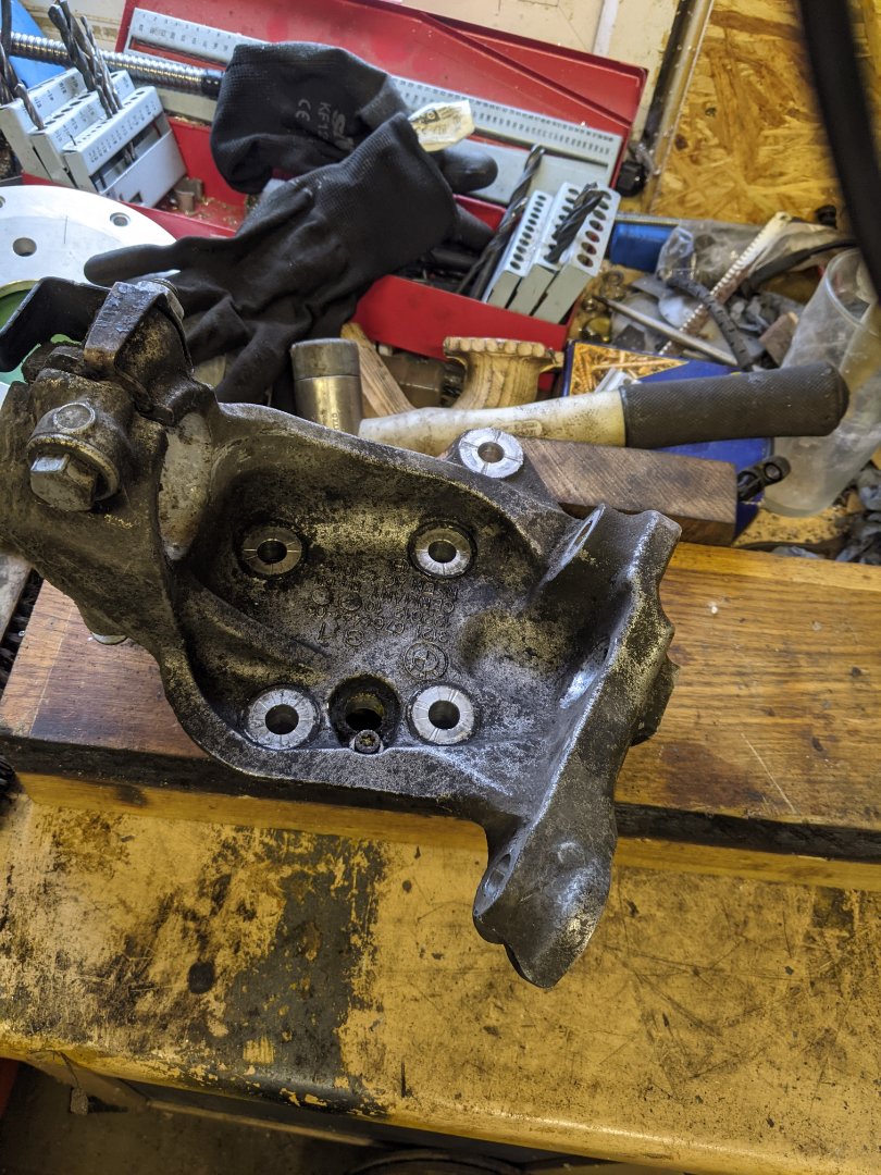

Worked up a sweat hacksawing the unwanted bulk off the bottom of the E90 today, it's remarkably light this casting when nothing else is attached!
Popped it on the machine and cut away the bottom of the casting to clear the adapter, need to run one more program and this is hopefully done!
Time permitting I'll make a couple of temporary long bolts for my mockup and strip the suspension from the car ready for the 3D printed adapter.

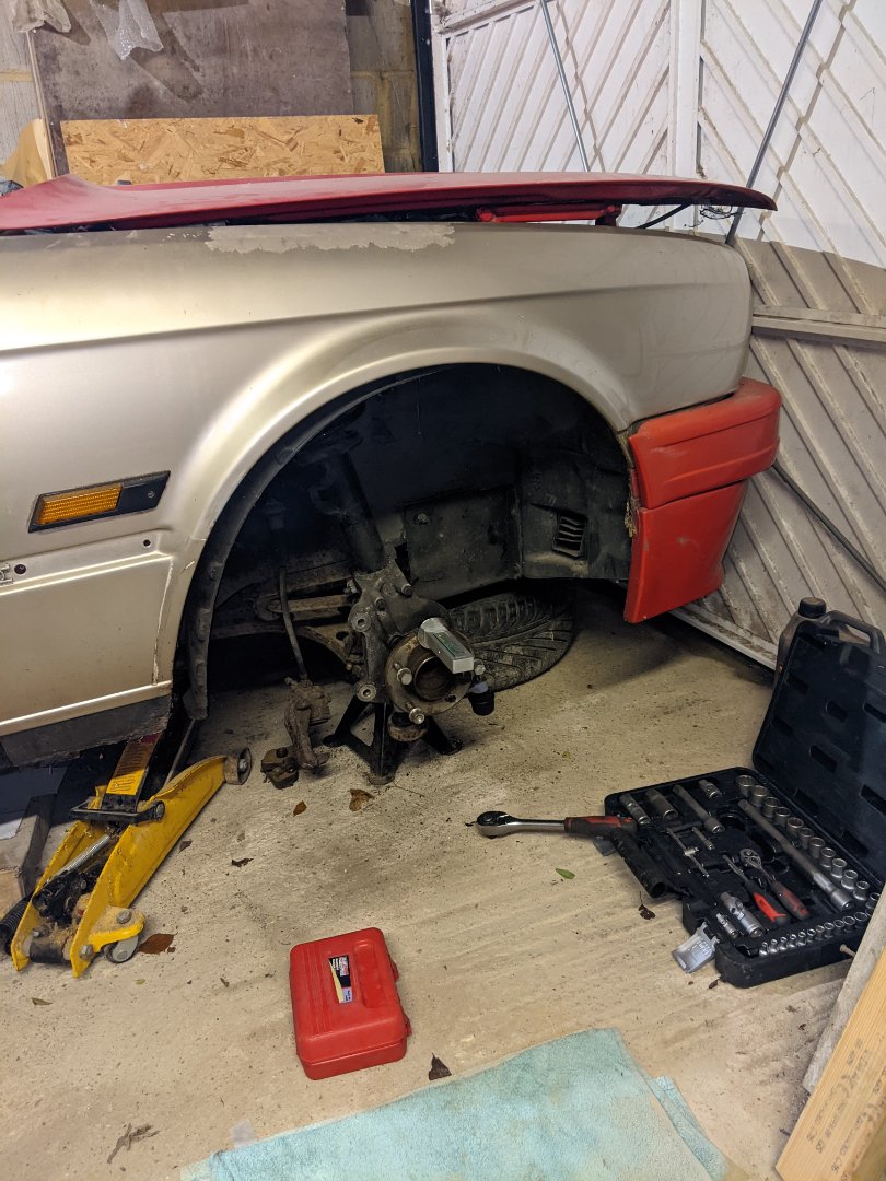

Old strut removed, despite looking like the whole front suspension has been in the sea, everything came off dead easy!
Took some very vague measurements of the old strut and zeroed my camber gauge to compare to the new setup.
Hoping I can swap the top mounts over as the studs don't line up.
Couldn't resist offering up the new strut too.
3D print is coming along okay apparently so hopefully tomorrow we'll know if this all goes together!

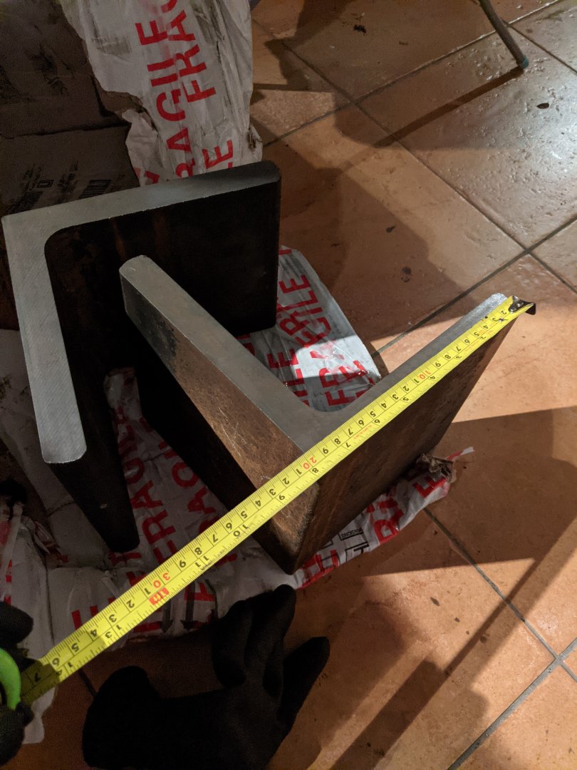

Found a source of the steel angle who are willing to cut me off two 180mm lengths so that's ordered now.
Each piece will start at 13kg and end up around 1300g!
Lots of that will be offcuts rather than chips though

We have material!
Absolute beast of an angle this!
Need some vee blocks to mount on for machining, then toolpaths and we're making chips!
Oh and some design tweaks to clear the ABS sensors and couple of other things!
