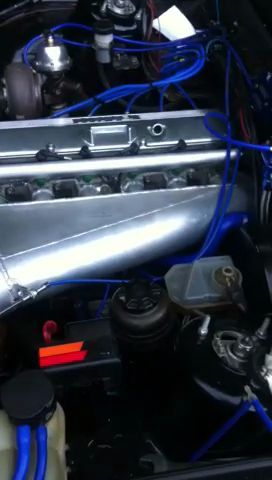

right guys as it seem everything was a ok stuck it all back together new manifold was also put on also a new turbo
got the bitch running today and ..................
it seems fine
as for where all this water was coming from I haven't a clue maybe it was just a dodgy head gasket here's a little vid of her running
http://i924.photobucket.com/albums/ad86 ... B1A688.mp4
