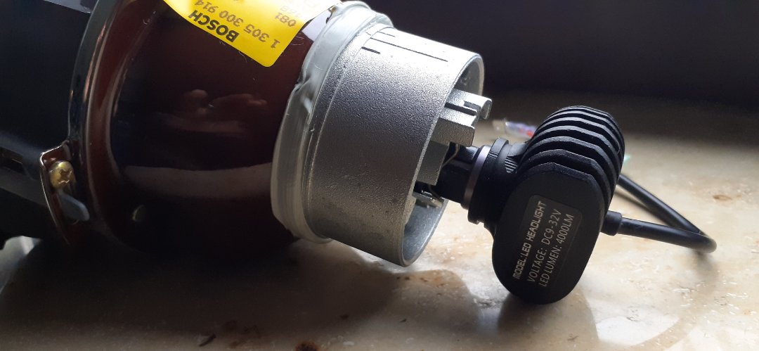

So the lamps extend from the base by 50mm - 10mm more than the H1 standard, but thats not at issue. Whether or not the light source
is correctly postioned for the projector headlamp or not remains to be seen.
Overall length of the lamp is 90mm and the widest part of the "power unit" at the bck is 52mm.
All in all, not huge.
The rear sticks out by 40mm from the mount point - this leaves a minimum of 17mm clear between the lamp rear and the standard plastic
cover on the E30.
You need this bit of space as the cable comes directly out the back of the lamp and not the side.
The guys at BCL also sell an adjustable rubber boot to seal the lamp - it's not that clear if it will adapt to what our cars are fitted with - and I'm not yet clear

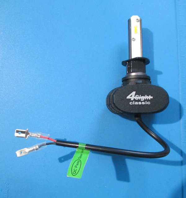

Ok...first impression...the LED lamp unit fits...its a bit of a struggle with the H1 clip as the flange is fatter and the heatsink kinda gets in the way.
So the next issue is finding something to seal the huge gap and stop moisture ingress.

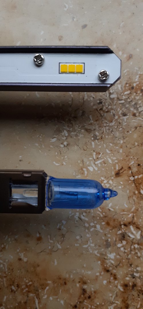

The position from the base of the leds is identical to a standard H1 as is the length of the filament and the led chips.
There are two rows of chips, one on each side and they face "east west" so there maybe a dull centre north and south...if this makes any sense. Obviously any standard H1 or HID has a point source with 360 degree output.

Brianmoooore
- Posts: 49360
Looks promising so far.
As long as the fitted position of the LED chips is facing horizontally left and right, the dull patches shouldn't affect anything, since they will be in the sky and too close to the front of the car to be seen.
A similar situation exists with The LED striplamps which have replaced industrial fluorescent fittings in recent years. I've fitted hundreds of the former and dozens of the latter over the years, and although the LEDs have a lower total lumens output than the fluorescents they replace, the illumination on the ground is every bit as good, since the LEDs are directional and the fluorescents radiate in all directions, wasting some light to the sky and into the fitting.

To avoid radical changes to the wiring in my car I've removed the "lucar" connections from the bulbs and added waterproof BMW male connectors which plug directly into the loom headlamp socket. This has of course voided the return policy on the lamps. Oh well, all in the spirit of true R&D.
Paul

I have some results.
In physical terms the lamps are about as small as you can get ( the electronics at the back ) I guess this is as they are 25 watt units. Fitting them is a bit of a pain and as the power cable extends
from the rear of the unit, although flexible, the whole thing impinges on the headlamp plastic housing covers - more on the right hand side of the car .
To avoid the cable rubbing on the plastic and getting damaged in the long term, you need to open a hole in the plastic cover - not so much on the left side where there is a little more room due to the moulding shape to clear the ABS.
Connecting is pretty easy as I posted earlier, just requires two pairs of BMW waterproof plugs.
The big problem as I see it is the fact that there is no easy way to fit a seal around the rear of the LED unit and the lamp housing to keep moisture out - I've made a tempory seal using foil and Tesa loom tape which is tough but not goopy like electrical PVC tape.
I discovered that you can withdraw the lamp from the base - mount the base in the carrier and then push the LED unit into place ( must be the right way round ) This helps with fitting.
So what about the performance? and is it worth it.
I currently use Osram next generation Night Breaker Laser H1 bulbs at around 14 euros a pair and these LED units come in at about 120 euros plus the wiring at 20 euros. The LED's have a 5 year guarantee whilst the Osrams last 50% of normal H1 lifetime. The output of the Osrams color temperature is 3500 Kelvin and produce 1550 lumen.
The LED units color temperature is 4300 Kelvin, so a little whiter but still very warm and almost identical to the Osrams. The output of the LED unit is stated as 4000 lumens so about 2.6 times the light output assuming the manufacturers use the same baseline to measure with.
My first impressions are they are no way as good as my old illegal HID's but the beam pattern is clean - they feel a little whiter and have greater throw than the Osrams - they kind of feel about 25% stronger. I'll take a shot at night to illustrate but it's really hard to quantify.
Is it worth it?
I put a lot of importance good lighting, hacking on the motorway in the dark winter nights in pouring rain, fighting the ludicrous over powered lamps of other drivers SUV's, which are a) so high up in the first place and b) designed to fry your retina's whilst the BMW is so low to the ground - anything helps!! My opinion would be that these units are good - lets see how long they last but I'm not sure they are that much of an improvement on the Osrams and for the price difference its really hard to recommend them I'd say it's down to personal preference.
I'll get some shots done in due course.
Paul
