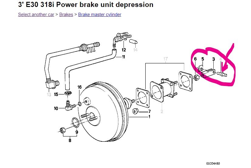

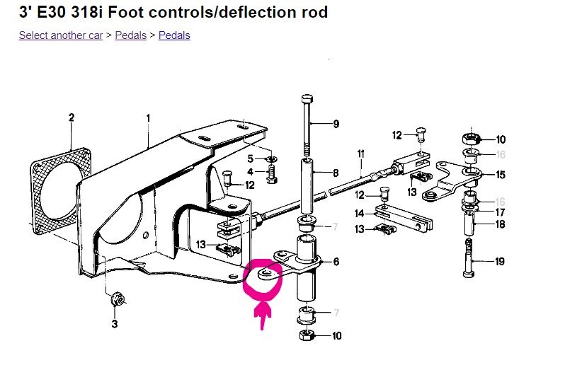

That still sounds like the cross bar between pedal and servo is not adjusted correctly if the brakes are dragging,, look at the two screenshots the pin that connects the servo rod to the cross linkage pivot should go in easily without needing to put pressure on the servo rod, that way the brake is not in the depressed position with the pedal at rest.
With engine off the pedal should be firm, if you start the engine with your foot on the brake you should feel the pedal go down a bit more as the servo assistance comes in. when you switch off the servo should hold enough vacuum for two pumps before the pedal goes firm again.

i'll have a look at that bar in the next few days soon as i get chance, also, when i fitted the servo the fork lined up perfectly with the linkage & didn't need to be moved at all,
steve_k
Posts: 8044
Post Wed Feb 01, 2023 12:15 pm
well i've had a look at the pedal & cross bar this morning,
there is about an 1 inch "free play" in the pedal (it moves freely back & forth) before i can feel any resistance or pressure, i wasn't able to adjust the cross bar/linkage as i couldn't find my 7mm spanner (off to get a new one soon),
but while i was there, laid across the seats, i noticed that if i press the pedal down i can see the linkage & pushrod working as as soon as the pedal is pressed the pushrod moves forward.
