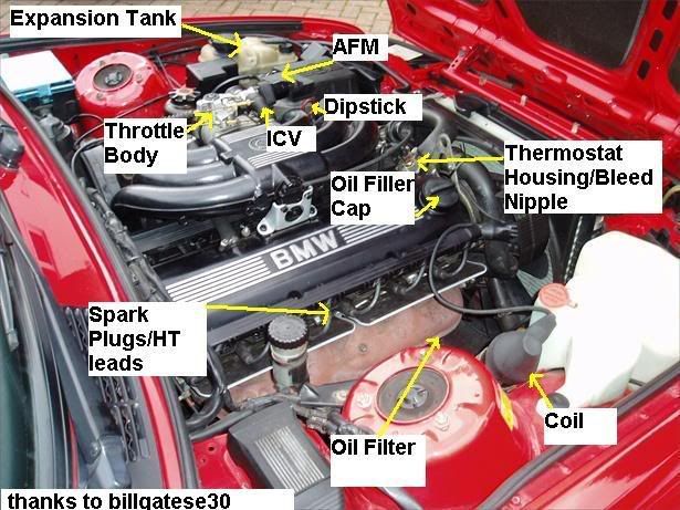

ok but where is the ICV located?? this first time ive owned a bmw e30 so not to sure on where the bits are..been lookign for an onlien diagram of the bmw engien with points on wat is wat and hwo to remove etc but had no luck??!?!

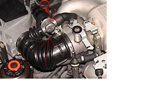

somes posted an engine diagram on here before but cant remember who so il put it up again...

icv
