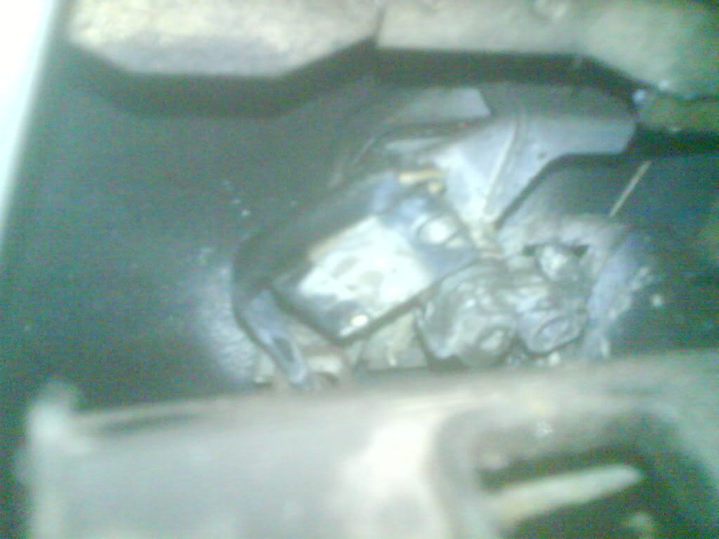

Cheers Brian, I have taken a pic and a video of the problem...
For some reason, turning the key doesn't push the fork down far enough, but if i stick a screwdriver in there, and push the fork down, it works... Will bending the forks help?? It seems that the spring on the back of the barrel seems to give in too easily, if that makes sense!!

Can't make out anything usefull from the vid or pic - to much out of focus.
Have you tried adjusting the lock motor in its slots?
