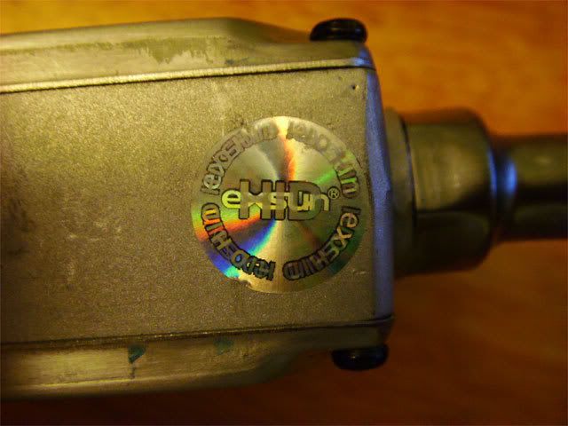

Just looked at mine, the hollogram has 'exsun' on it.
Quick google - http://www.exsun.com/Product.asp
Look familiar? :)
Only thing that looks dodgey to me is that the sticker has 'Made in Germany' on it.
If thats true then why are we buying them from the US? :?

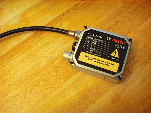

These are fake Bosch HIDs kits as bosch doesn't make HID products anymore, they have a subsidiary company which is called AL (Automotive lighting).
Also just to if anything those look like Philips ballasts and are very good copies!

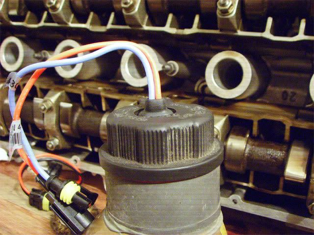

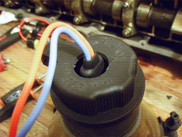

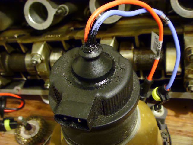

Well I got round to fitting the bulbs. Just got the ballast units or whatever theyre called to fit now.
Heres what I did, as you can see the bulbs are a bit too big, I found a couple of connector grommets from an engine loom I had lying about and filled them with sikaflex for extra waterproofing.

here look at this label its says they made in gremany then its says HK International investment company HK means hong kong

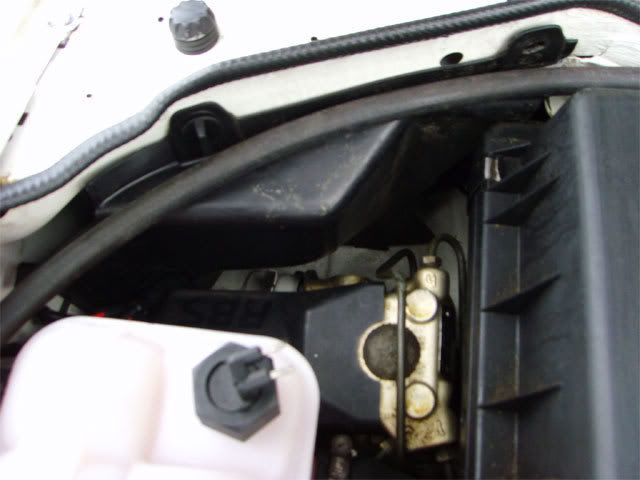

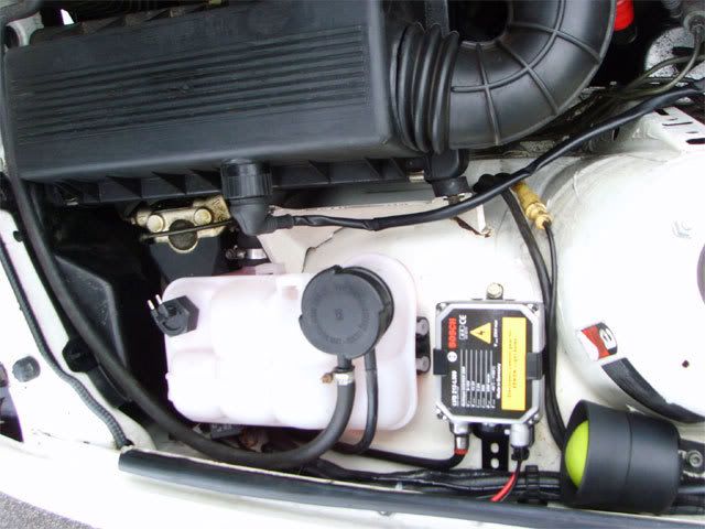

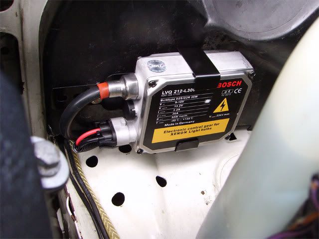

Just got mine finished.
No problems with the off side, mounted on the back of the plastic cover to keep away from water.

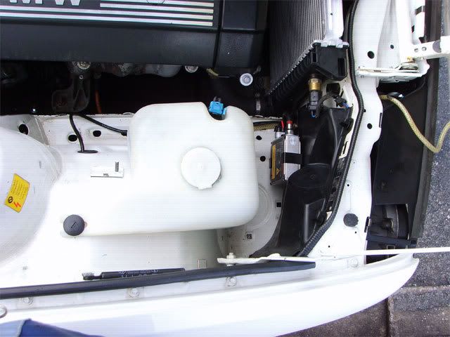

Then got to the near side :?
So had to mount it here
Noticed they make a quiet, high pitched noise when on, will put some night time pics up later.
