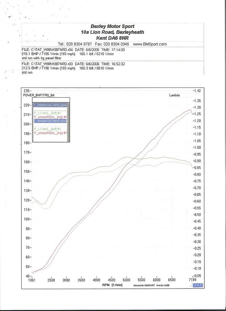

From my own experience I'm not sure that a change of filter or an induction kit make a great deal of difference on their own. When I had my 2.7 conversion and gas-flowed head fitted I thought the engine was a bit 'strangled' and put in an ITG panel filter This didn't make any noticeable difference to performance. I then had the airbox drilled out on the front and non-engine side. This just made it noisier. I then had a zone bigger throttle body fitted and did see a difference in absolute top end power and torque. (see the comparative power curves ror my car in the zone articles on BBTBs) . After doing these mods I found that the AFM itself was strangling the car. I had a MAF conversion and fitted an ITG cone filter. After a remap these mods made a real difference to power and throttle response in every day driving and at max performance on track. In other words, unless you can get more air in all the way through to the combustion chamber you're probably better off sticking to the stock air filter. There have been several tests carried out by zone members and others (some good time ago now) that show that the standard paper filter actually performs better than most induction kits although I believe BTG ones with the carbon box show some sort of improvement.

Moving onto the panel filters, I did a before and after dyno test on my E30 M3 with a brand new BMW filter and an ITG panel filter - the results speak for themselves:
Thanks
Sal
