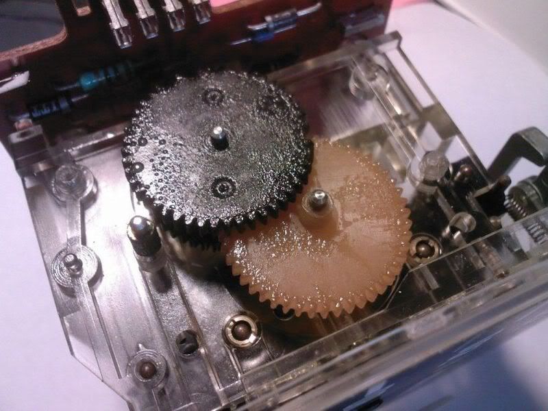

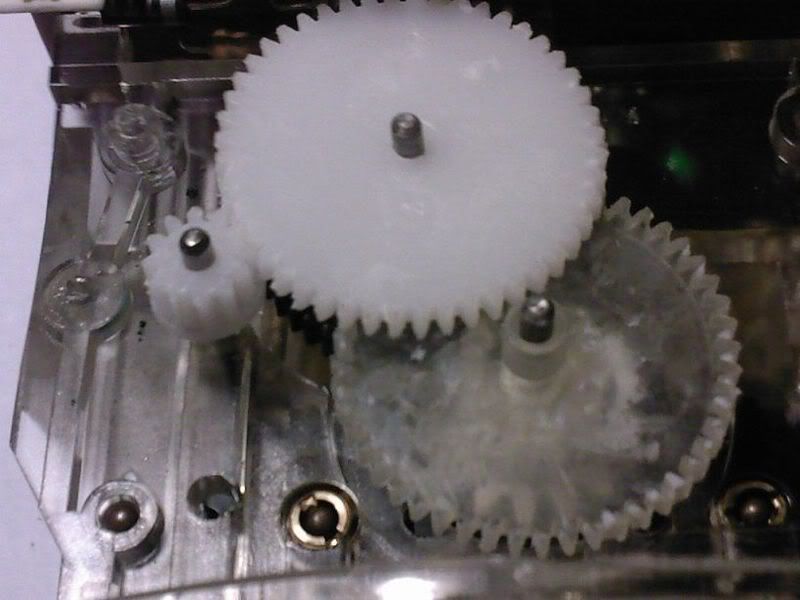

I would be interested to know this, mine not working. What happens in hot countries is the cogs seem to go soft and the teeth shear off, my cab had three gears half stripped, my sport I still need to investigate.
If you buy the scaelextric cog could you take a photo for me?
Found some pics, upper pic shows what goes wrong, note small cog gone and teeth missing from black cog. Lower pic shows with replacement cogs from neic@bigpond.com or contact@ottoinstruments.com.au about 60aussie dollars.
