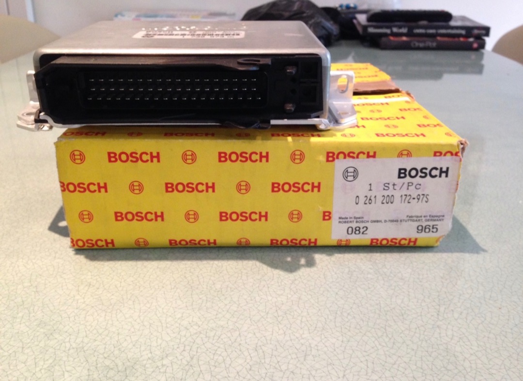

ECU replaced with deadstock unused unit. EPROM swapped over.

Why was the EPROM swapped over? Also, it's worth checking basics such as engine-to-body earth strap is in good condition.

The Bosch deadstock ECU didnt have one.
I have heard about ICV’s burning out ECU’s. And i replaced the ECU before the ICV, so im a little concerned that the old idle control valve burnt out the new ECU. Or maybe that’s just folklore.

Which new ECU did you fit? AFAIK, it was only the later 0 261 200 380/381 ECUs that suffered from blown diodes in the idle control circuit - the previous 172/173 ECU didn't have that problem.

It was this one. Numbers were exactly the same as the one that was originally in my car.
That's interesting though, I always thought it was every one impacted. Off topic, but I wonder if the Eprom may be playing a part in this. It's one of the only constants.
