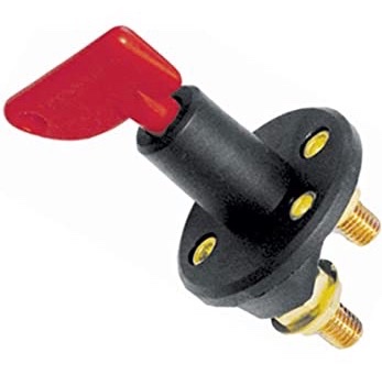

Something like this looks about right - also seems to have a cut-off to keep voltage to stereo, although wiring that in may be beyond me
Battery is new and fine, just want to keep it disconnected while in storage for 1-2 months at a time so it doesn't drain - more of a preventative measure

Ideally, any cut off switch should be in the battery negative lead, which with a rear mounted battery, confines it to the boot. The switch with the red handle, above, is suitable. These switches are also used in touring caravans as isolators for remote control movers, and recessed housings are available to mount these switches in for a tidy installation.
The clock, radio memory, SI board, etc., ARE what drains the battery, so little point in fitting a switch with a bypass resistor.
Don't forget that if you have the later type of SI board, the batteries will fail after a year or two of cumulative battery disconnection.
