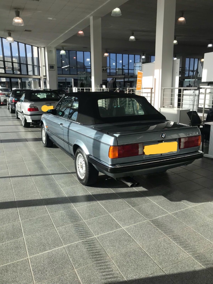

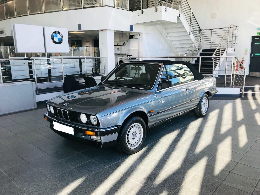

Hi all...my first E30 so lots of questions to come!..
A couple of phots for you. already finding your site invaluable.
