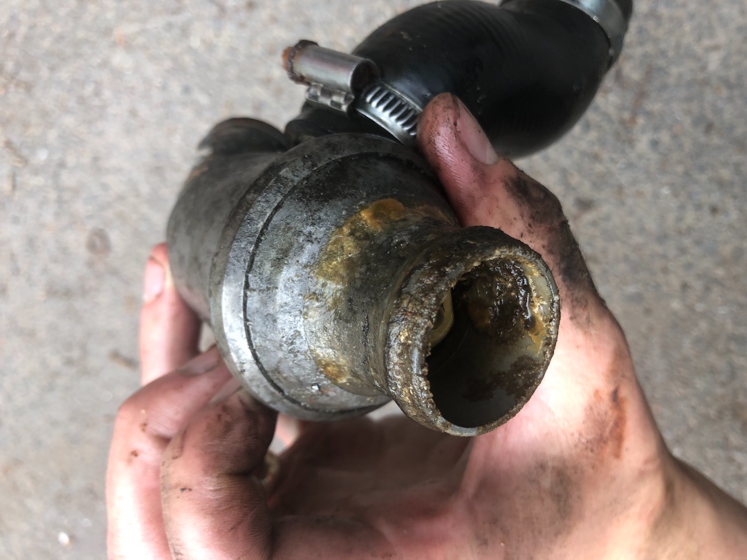

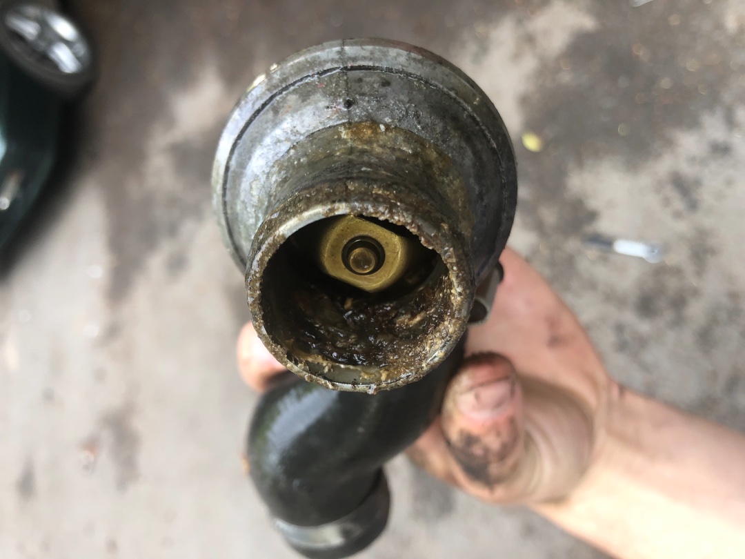

Old Thermostat looks like this:
What is that stuff!? It’s rock hard.
