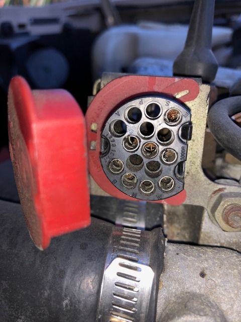

Hey Brian,
I went to do as you suggested bridge the terminals.. However They are not numbered they are lettered. Only the outside ones have the letters not the inside which is blank.
Any Suggestions?
Brianmoooore
Posts: 49359
Thu Feb 08, 2018 10:13 am
Looked inside the cover? That's where the pin numbers are on UK E30s.
Otherwise, there's a diagram in the wiki.
