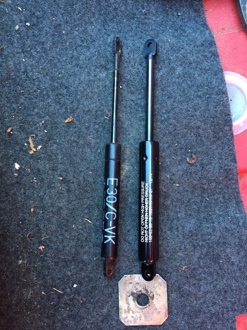

Just fitted this 'able-goods' set from ebay, posted from Germany, very happy!
One on the left is the old one, on the right is the new one

petchy
Posts: 394
Joined: Sat Mar 04, 2006 11:00 pm
Location: South Shields
Sat May 09, 2015 11:00 pm
Simple, little circlip holding top and bottom, couldn't be easier! :D

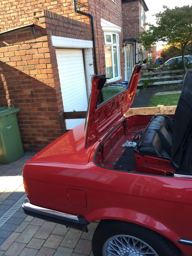

ianev
Posts: 153
Joined: Sat Apr 25, 2015 11:00 pm
Location: Redhill, Surrey
Wed May 20, 2015 9:51 pm
the c clips were ridiculously hard to get off. I would suggest removing the top c clips first (as more accessible), then freeing off the top of the strut, wiggling it a bit top give more access to the lower.
please tell me how you replaced the c clips as mine look a bit mangled and I doubt I'd have the patience to get them on even if they'd go on anyway.
anyway job done and tonneau stays up 8)
ianev
Posts: 153
Wed May 20, 2015 10:35 pm
oh yes - an upturned plastic washing basket makes the perfect prop
