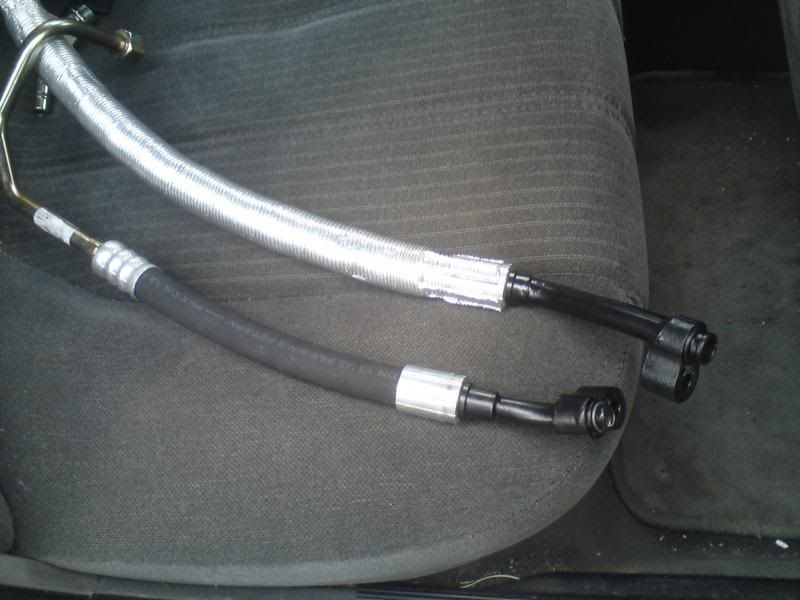

Ive got a bit of experience under my belt :)
Made plenty of custom connections for aircon swaps, oil coolers etc

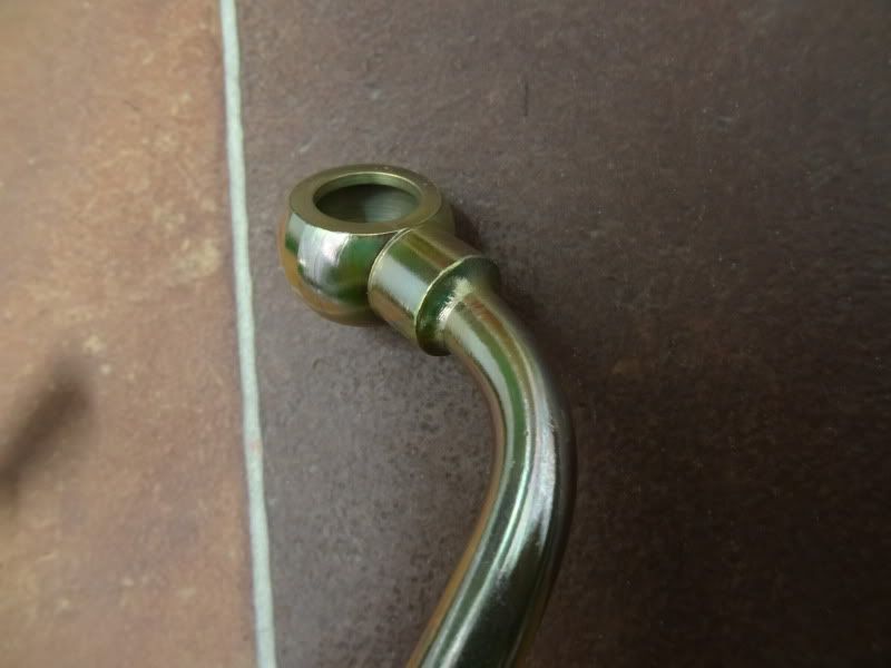

Dan that looks nice work. Made a right mess up pushing car back into the garage when it started raining. Had the front of the car off and as I pushed the car back in the flexible lines had draped down and got caught on the wheels ripping the fittings of the condensers.
This is the bit I need de brazing from the fitting with a new bit of pipe let in 3/8ths.
This will then need joining onto the damaged condenser
unfortunately It done two of the fittings

The condenser tubing is copper, not something im familiar with in terms of brazing. Your car looks like a 333i? Im guessing the condensers are a bit special and not easily replaced, so its not really something I would like to test my skills on!

Yes it is a 333i, not factory AC though, it came with PAS as you couldnt have both from BMW. The AC install is aftermarket from diavia. Yes copper, beauty of copper is it is so easy to swage out for cost free couplers. Just a case of getting the right temperature but as you say need to test on a few bits of copper first. Spoke to a guy up the road who does commercial refrigeration he said he would give it a go, prefer someone on here though who likes cars.
here is a better picture of the damage, all doable I reckon
