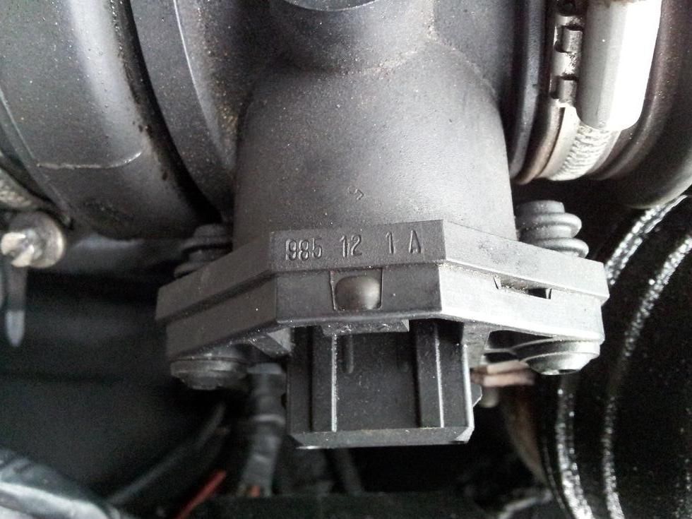

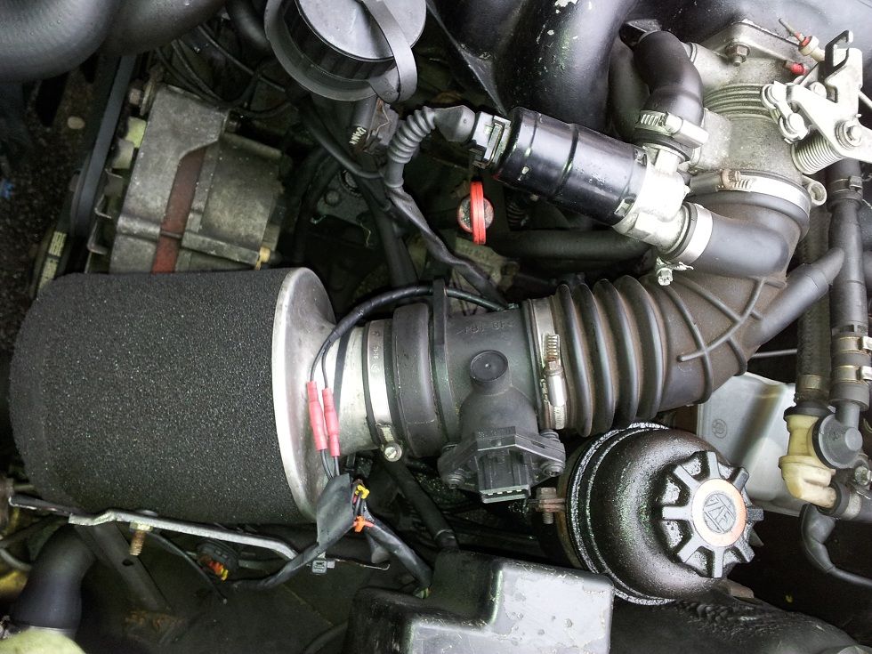

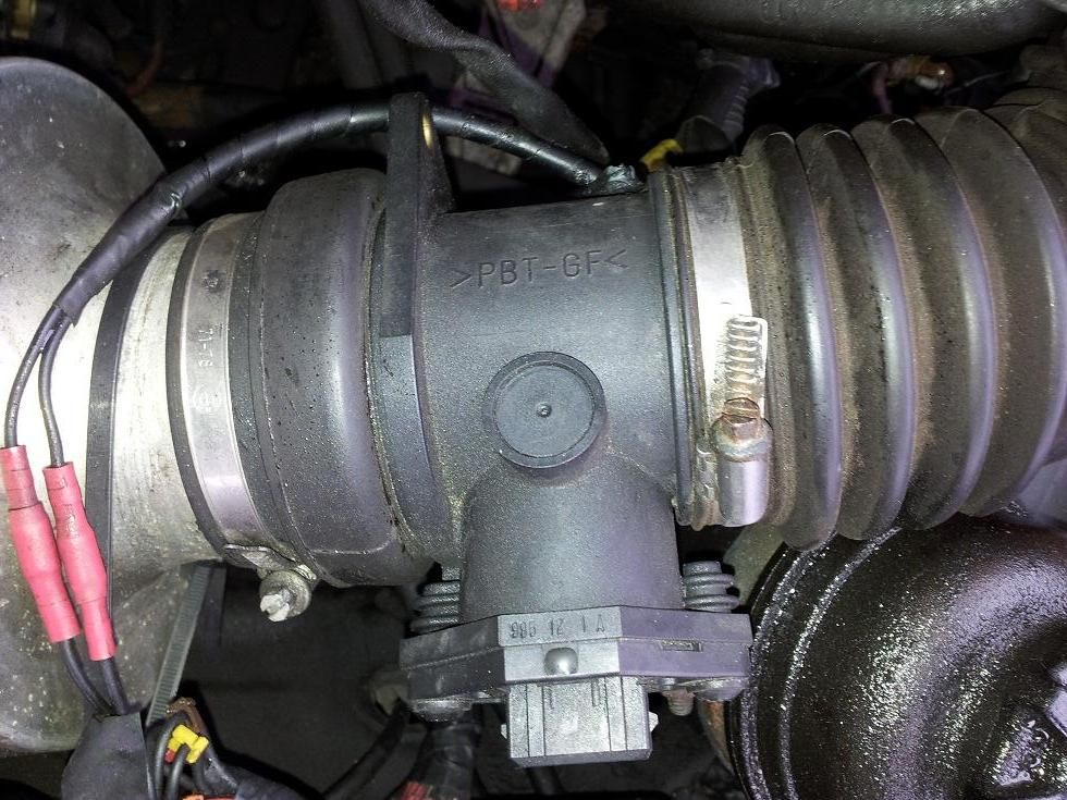

Pics of mine below... someone may be able to identify what it came from???
I presume the cable going into the intake boot just past the MAF is some kind of air temp sensor?
I know, I know, I'll make a bracket for that air filter one day!!!

Miniblob, that looks like either a Volvo Maf or a hyundi unit, google any part numbers you can find on it.
