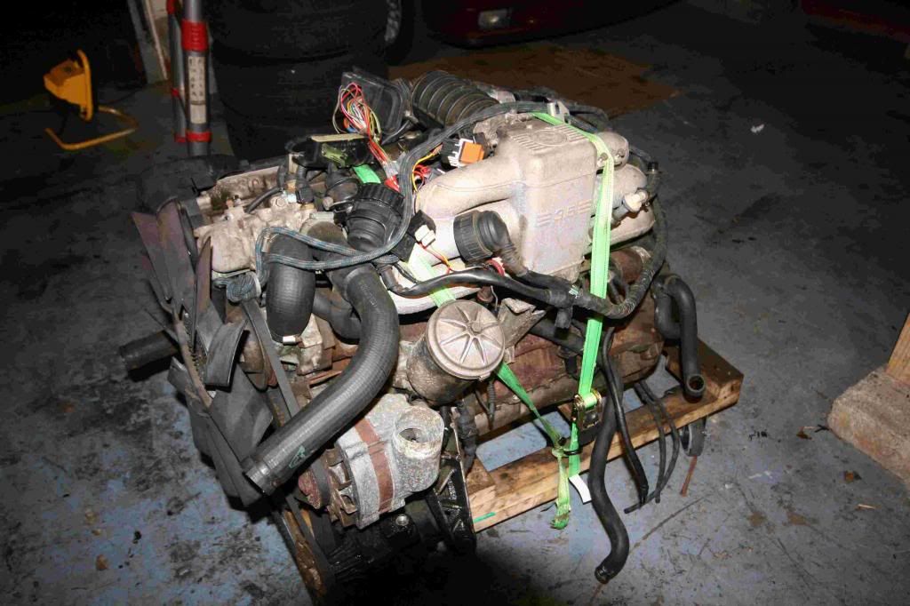

Right well good old Rob on here fitted the new engine and it solved all the problems i had but......
It has low compression on all 6 cylinders - about 80psi every cylinder roughly the same
Now, the timing has not been changed, the engine went in lock stock complete
It did idle and run perfect when we put some oil down the bores to bump up the compression but after 5 or 10 mins running it just died and wouldn't start again.
Hot compression test was 80psi all cylinders
Also, when cranking the engine over on the starter, if you take off the oil filler cap, all the compressed air from the pistons comes out the filler cap, looks like an exhaust !!
There is a lot of oil in the intake system also
So 100% the rings are not sealing. The odd thing is, it was a perfect running engine in the donor car. So why is it not running now?
I've ordered some miricle oil to soak the rings in and hope they seal again, otherwise it's a new set of rings needed.

- Posts: 13598
did you see it running in the Donor car? the pulleys look to have a fair bit of rust on them in the pic... suggesting it's been sat outside for some time ?jimbom30cab wrote:The odd thing is, it was a perfect running engine in the donor car. So why is it not running now?
the miracle oil will work just as well as the magic beans my mate got down the market at the weekend

Mate ......no amount of miracle oil will cure a tired engine !! Am happy to take a look if you could leave it with mee30topless wrote:did you see it running in the Donor car? the pulleys look to have a fair bit of rust on them in the pic... suggesting it's been sat outside for some time ?jimbom30cab wrote:The odd thing is, it was a perfect running engine in the donor car. So why is it not running now?

Actually .....i read somewhere that that stuff is really good at rust removal !!
jimbom30cab
- Tech 1 freak
- Posts: 7634
- Location: in the garage
Thanks guys and Gus for the offer.
I have faith that the miracle oil will not only get her running like new again, but remove the rusty bits, polish the bodywork, rejuvinate the interior and give a big hike in BHP.
