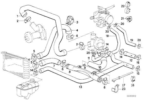

Before you jack it up, check the 'top hose'. I just had the same leak (I think).
Top hose connects to thermostat at the top end of the pipe and water pump at the bottom end of the pipe.
No. 1 in this diagram:
At the beginning of the video you can see water leaking around the area of the bottom of the pipe (the jubilee clip even looks rusty so it may have been leaking for a while). This water looks as if it is dripping down onto the oil pressure sensor and is being sprayed around a bit by the drive belts etc.
I just had the same thing. It was a split in the top hose (at the bottom end of it - or left hand end in the diagram) just where it connects to the water pump.
I fixed mine by doing this:
I put a washing up bowl under the car.
Undid the jubilee clip at the water pump end of the hose.
Drained the coolant.
Undid the connection at the top end of pipe from thermostat housing.
Took the pipe off.
Found the split in the pipe. (It was near the end of the pipe - your looks the same).
Cut the end of the pipe off at the split (about 10mm off the end of the pipe)
Refittied and refilled and no problems.
Have ordered a new pipe for £11 from here just in case.
