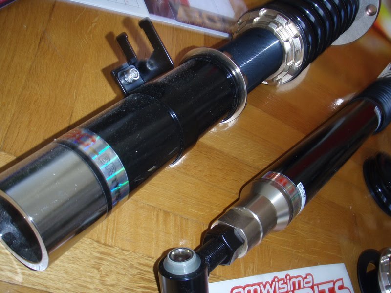

If your getting BC's there's no point wasting a pair of good 51mm struts if you already have 45mm ones.
The only difference between BC's 45 and 51mm is that the bottom piece thats welded to the bottom of the strut is thicker to make up the difference between 51mm and 45mm, other than that the whole setup is the same :thumb:
---edit---
The wall thickness of the silver part of the bottom piece of the coilovers is thicker for 45mm struts than 51mm, no difference other than that.
Make sure not to cut it to long or you will have less room for lowering because the BC shock is hitting the strut stub.

Jozi, are those bcs for your e30? My bc rear coilover doesn't look like that one! 8O
Jozi
Posts: 3076
Location: Dublin, Ireland
Wed Nov 07, 2012 10:46 pm
No, they were a picture I googled. My rears are nothing like that either. Their on the car at the painter so couldnt get a pic of them.
