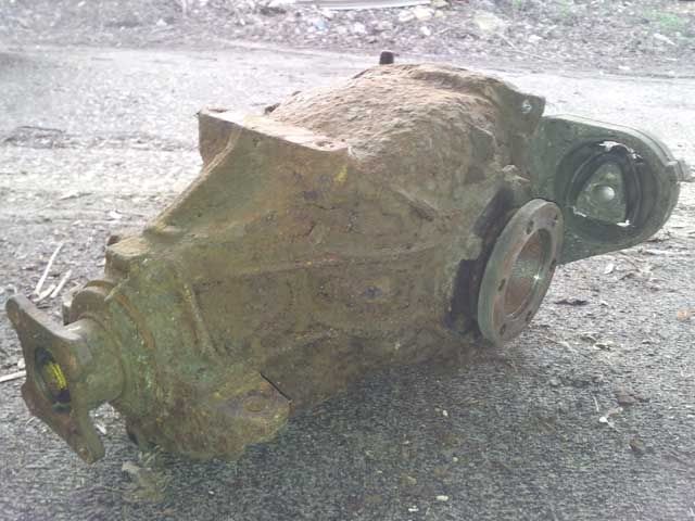

Got this diff which is just in the way, took it along with a load of other bits a few years back.
I'm sure the guy told me its a 3.91 LSD, so i kept it as a spare, but I can't find a tag on it!!!
Where should the tag be??
Any other way to tell what it is??
Also, it's quite hard to turn by hand, both outputs turn the same way (iirc) and it feels a bit rough!!!
So is it just scrap?? Or do they never turn smoothly by hand??
What's it worth??

Tag's on one of the bolts that hold the back plate on. If there's nowt there, just take the back plate off & post a pic if you don't know what a LSD looks like! :)

Sounds like a lsd by the way your turning it... To work out its ratio, mark top centre on one of the side parts and on the prop bit then turn the prop part, counting how many turns it takes to make a full circle on the side parts...
Definately not scrap!

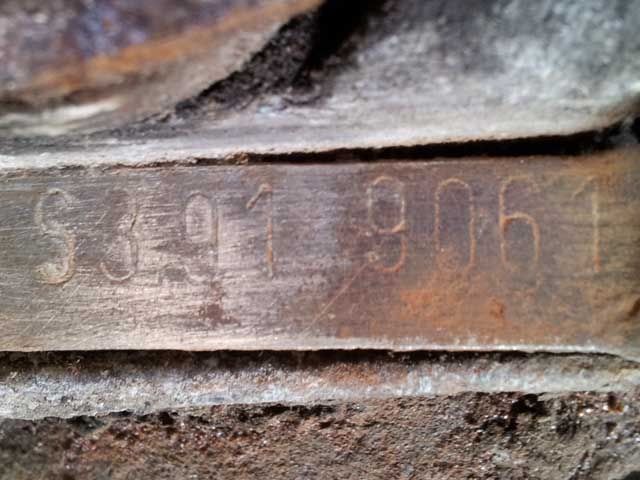

Found a tag!!!
S3.91 9061 - anyone know what the last 4 digits mean???
