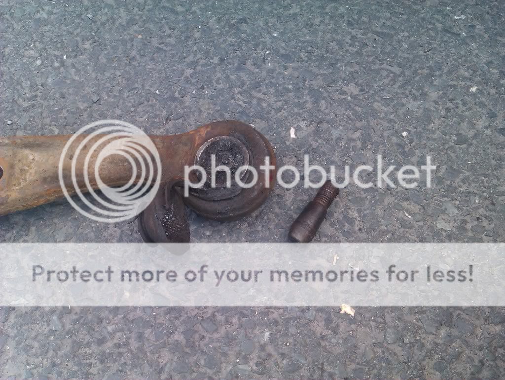

Taken off the steering rack bolt, undone the top bolts (inside bonnet) but for love nor money can get the lower swing arm ball joint bolt out.
All i wanted to do was to replace the springs!
Heres some pictures to explain what i'm talking about
so iv taken this one out
But cant get this one out!
can anyone help me?

Get hold of a ”ascissor”a type ball joint splitter & use that & it should come out.
Posts: 9681
Location: South Staffordshire
Thu Feb 02, 2012 6:06 pm
Screw the nut back on so that the top of the thread is protected and give it a quick whack with the tapping stick :twisted:
Even if you knacker the nut up a new nut is cheaper than a balljoint splitter - I did the whole of the front end of mine without using one :wink:

Iv already got this.
http://www.halfords.com/webapp/wcs/stor ... yId_255216
and also this
The first one is the wrong design to fit, and the second, the prongs are too far together!
so you think that will work?

Right, forget all this about scissors, splitters etc etc. You need a lump hammer, and you need to give the bottom of the leg a few good sharp whacks on the square end of the bit that the ball joint goes through, the bit facing you directly in the bottom pic.
The shock makes the joint pop out without even touching the ball joint or the threads. I haven't damaged a ball joint in years, and own both types of splitters, they do stirling work as paperweights. I never split a ball joint successfully with either type.
used to rebuild landys that have about 20 balljoints on the front steering and suspension.
1990 325i se "weinrot"-How did they know?
Thu Feb 02, 2012 10:10 pm
^^^ this, you need to fully remove the nut first and strike with precision !!
Which bit?!

ohhh, is this when the shock is still bolted in via the 3 bolts inside the bonnet?

The bit the taper/thread goes through. 2 or 3 precision WELL struck blows should do it.
Thu Feb 02, 2012 10:23 pm
leave the 3 nuts on the top mount strike the ball joint, much better if another person is Levering the lower arm down at the same time..
once the joint is seperated remove the 3 nuts up top, the whole shock/leg assembly will drop down once they are off so be ready to guide it down it before it ruins your wing/day :P

Iv managed to get it off using a scissor type ball joint remover.

Hitting the square bit of the metal that the ball joint goes through didnt work at all. had to use the 'scissor' ball joint remover. worked a dream.
