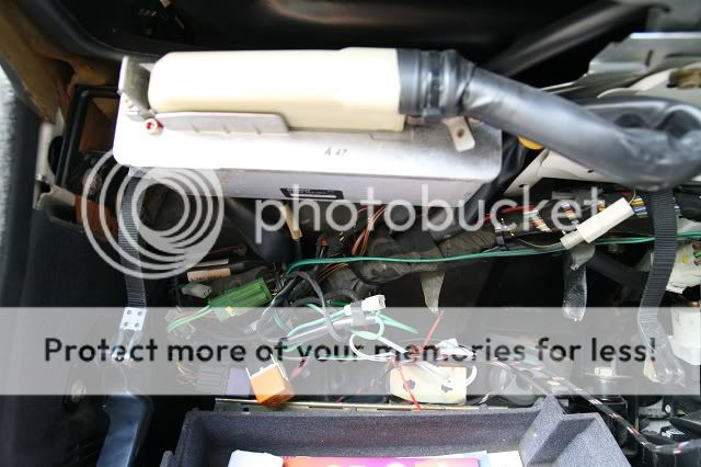

Sounded easy, except I had no idea what I was looking for. A further PM to AB clarified the situation somewhat and on removing the glovebox/underside trim I was confronted with this:

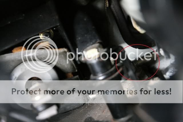

The link rod is a thin metal pole which as described above, runs from the pedal box to the master cylinder.
On the passenger side it is located here:

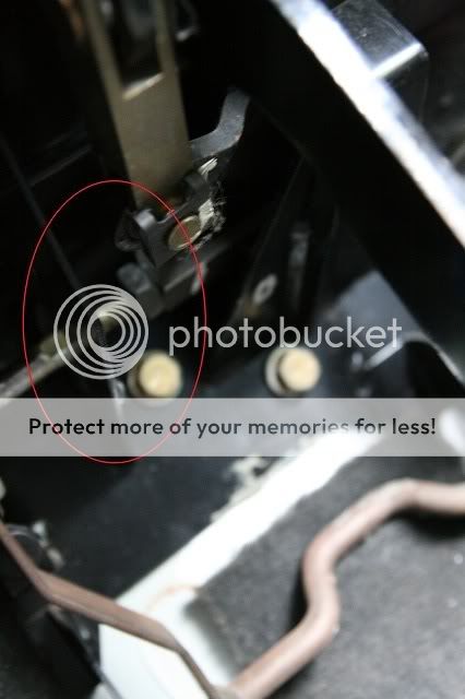

It then runs behind to the other side joining the pedal box
Bit tricky on the glovebox side (not much space to work in) but 17mm spanner gets the job done. Undo on the steering column side as well and as mentioned, use pliars to rotate the rod clockwise (if looking to the right). Don't do it too much or the brakes will be applied without any pedal pressure! I did wonder why the car wouldn't go anywhere, so it's a little trial and error trying to find the best balance.
