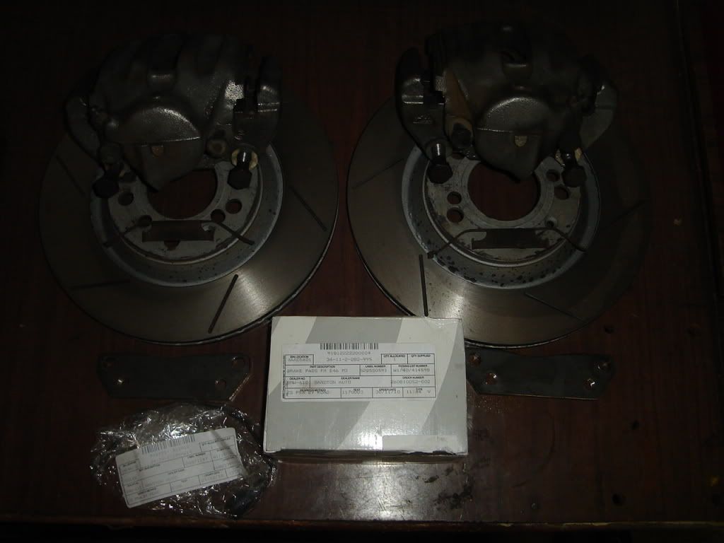

the kit costs R7500.
the specs are as follows:
discs: 300mm slotted and heat treated rotors. will fit 4 x 100 or 5 x 120 pcd
calipers: e32 733i (uses same pads as e46 m3)
adapters: self made
bolts: uses std e30 and e32 bolts to mount.
hoses: i used std e30.
pads: i used oem e46 m3 pads.
this is what the kit looks like

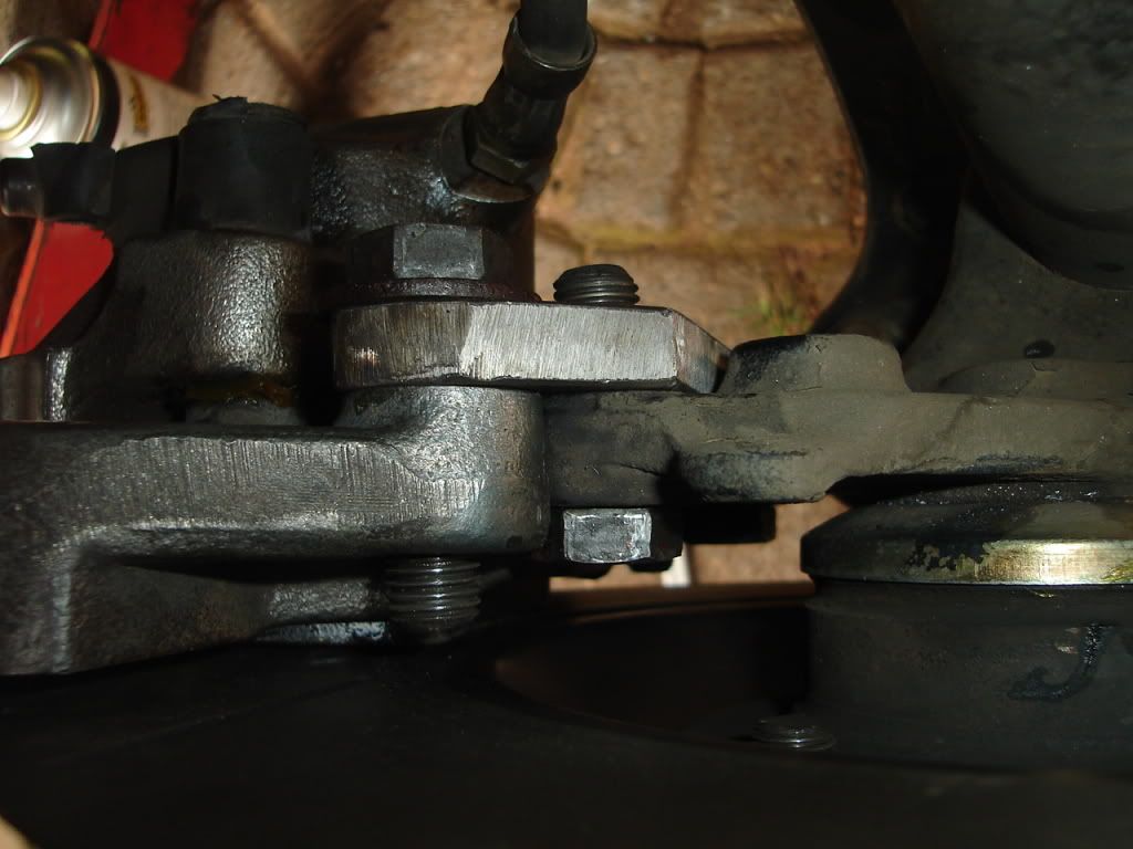

adapter plate from the inside

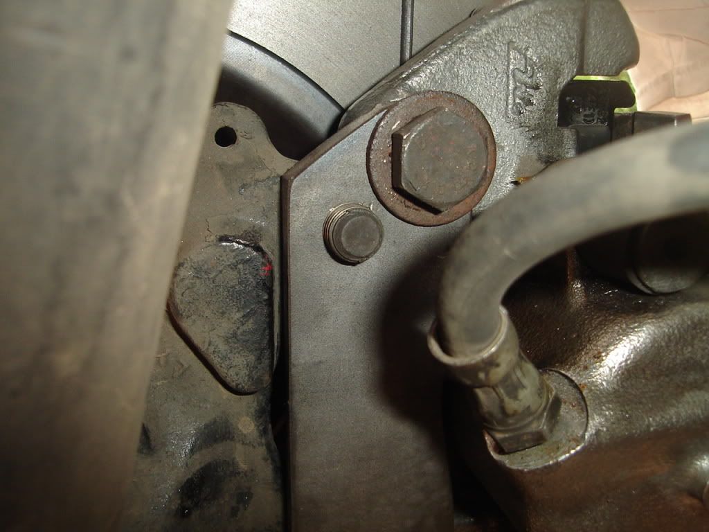

top view of caliper location and adapter plate

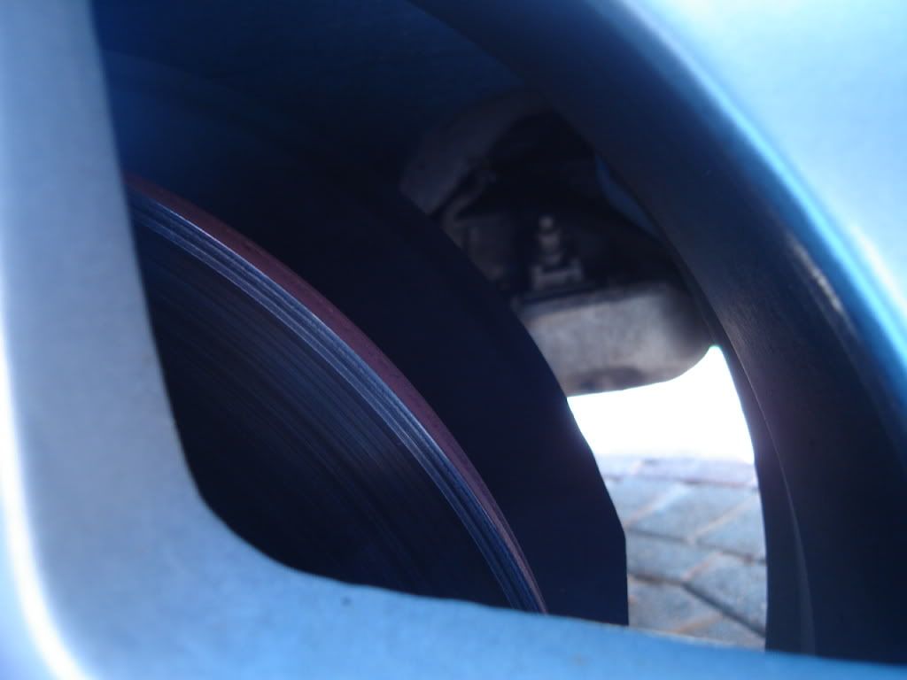

big brake disc to rim clearance

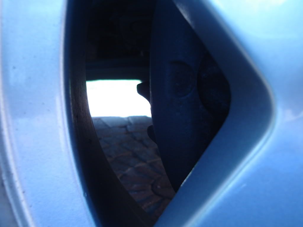

stock caliper to rim clearance

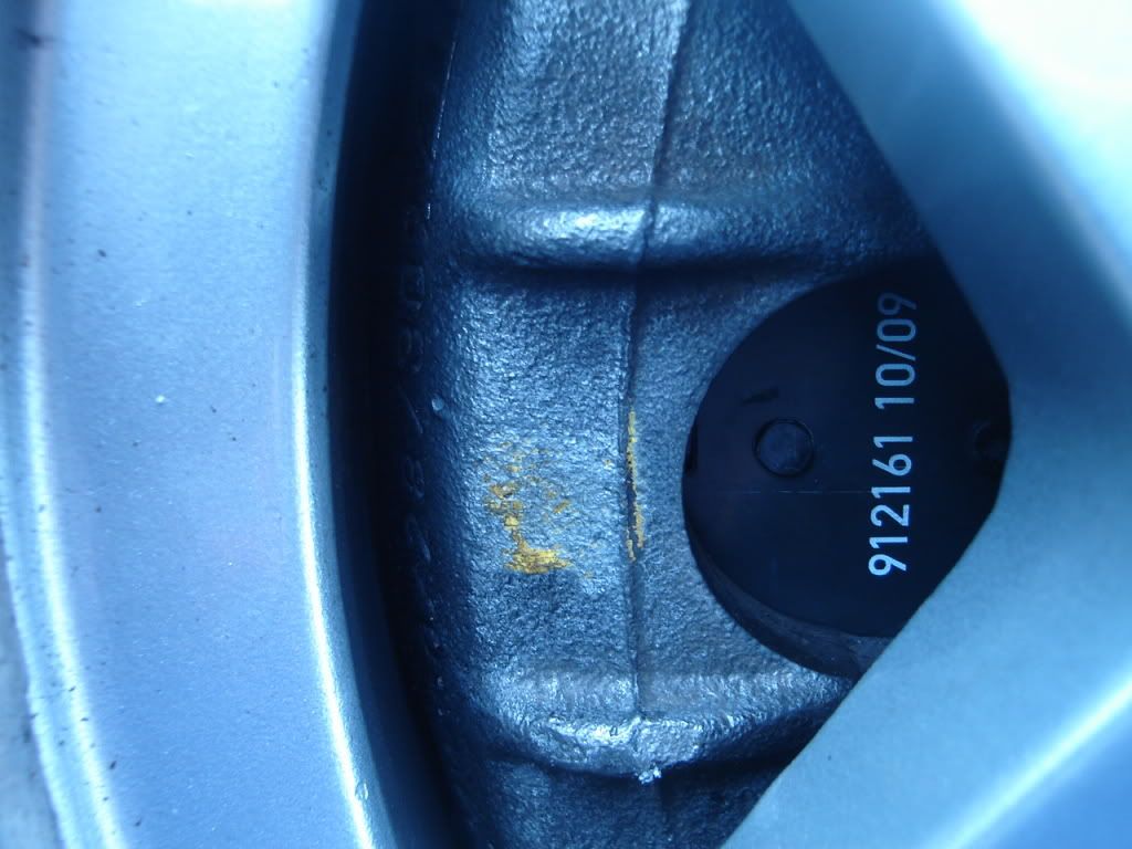

caliper to rim clearance, pretty dam close actually
