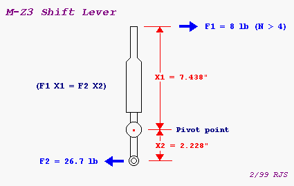

The Z3 shifter conversion seems like a very practical, simple and worthwhile mod. I have an M10 engined 318i. Will the shifter go into the M10 box? I dont know if E30s all had the same 5 speeder or not. Has this been done in Australia before, and is it expensive? Cheers

Yup, the bits you're changing are the same on all e30s...
