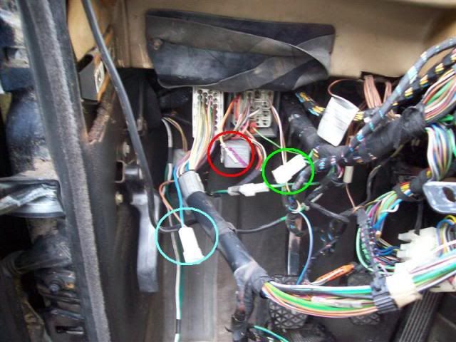

The biggest contrast by far from my other cars is the electrical system, and to make matters worse I've been removing an old alarm setup from the Tourer. I've now got it all out, but there are a few loose connections that I need to identify and tidy up all the loom. Here's the ones that are really bugging me:
The one in the red circle (thick yellow/red wire) is always live independent of key position, should it be plugged into something?
The one in the green circle (one green, one green/blue iirc) has one terminal that's live when the key is switched on, and the one in the blue circle (thin brown and violet/red) has no live leads, but I've traced this one (by accident) to fuse #28... so maybe it's an accessories plug?
By the way, what are those massive connector blocks in white? I'm not used to having a car whose wiring diagrams span a whole chapter... my classic Fiats have it all in one A4 page...

Wire in the red circle is red/yellow not yellow/red (although I can't really see it in the pic.)
This distinction is important, as the wire colours aren't chosen at random, but to a code.
A wire with a red main colour, in the body looms, will always be permanent live. This particular one comes from fuse 28, and is probably the feed to the electric aerial on any E30 other than a touring.
The ones in the green circle appear to be the immobiliser socket, and with nothing connected here your car should not run. There should have been a plug connected to this from your old alarm.
If you are lucky there will be a plug to fit this socket taped up to the loom nearby, which is fitted with a short loop of green wire. Cut/pull this plug loose if it's there and fit it to the socket.
If it's not there, cut the plug off of your alarm wiring, a couple of inches from the plug, and join the two wires together to form a loop.
Moving on to the blue circle, plain brown is always earth, but AFAIK, there's no purple/red in the area, and certainly not one connected to fuse 28.
Blue/red, I will believe, and this is the connection to the indicator repeater on the LH front wing.
The big white socket is the accessories socket as you surmise, and is for things like the radio, ABS, cruise control, central locking, heated seats, etc., several of which you appear to have.

Indeed, the big wire is red/yellow, not yellow/red, silly me! Is it meant to plug to anything? Seems kind of hazardous to have a live feed hanging there doing nothing... or should it simply be capped?
I was wondering about the green ones (solid green, btw), as they connected to a plug in the alarm (plug itself was BMW original) and it had two short bits of green but no apparent destination in the harness... so they're meant to be a loop, right? Makes sense.
The third one is indeed blue/red, not purple/red, and brown. Why is this one separate from the rest and hanging here? There seem to be no similar connections in the area, that's why I wouldn't associate it with anything similar to an indicator.
By the way, it seems a few of my diagrams do not match the actual colours present in the wires, so maybe they're an older/newer version? I have a digital-format Haynes workshop manual, but it spans E28, E30 and E34 models, so that could also be an issue. Do you know where I can find the correct wiring schematics for my Touring?
Sorry about the bunch of questions... still trying to navigate through my first "modern" car...!

Indicator repeater feed is unique to RHD,it forms part of the dash harness,that's probably why it's just hanging about! Should be a matching socket coming into the car behind the radio speaker,from the side repeater.

The end of the red/yellow should just be hanging there, but it should be fully enclosed by plastic, to form half of a plug and socket pair.
Green needs to be made into a loop.
Indicator repeater as daimlerman says.
