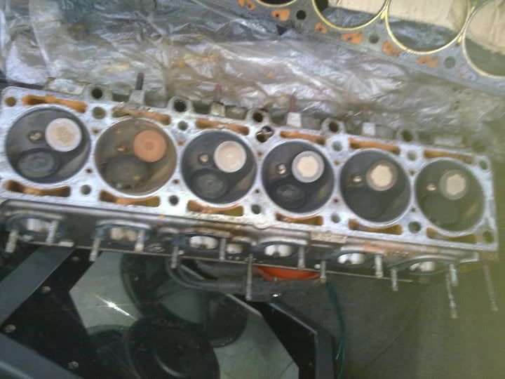

right well i got home from work an took head off to find what looks like a corroded head :? :?
its gone between the water jacket an the cylinder 5 but i still not 100% sure why it went all mayo in oil as dint seem to be any place it looked liek it was mixin

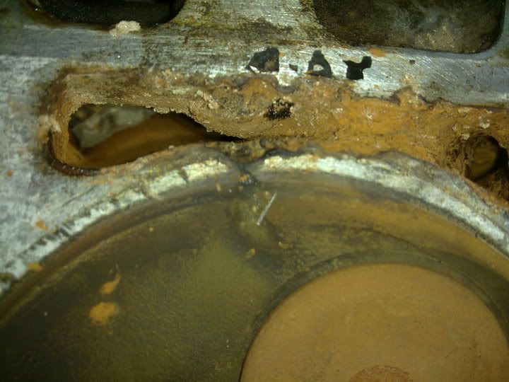

Tue May 25, 2010 8:28 pm
this seems to be the problem do ya rekon i can get this skimmed out 8O 8O 8O 8O 8O

Wed May 26, 2010 9:39 am
Ow... time to see a head specialist. Maybe they can weld and grind and fix it. I had to replace my head recently so I feel your pain :(

Thu May 27, 2010 9:02 pm
This is a common fault on M20's, and is caused by inadequate strength of antifreeze, or failure to renew it every two years. The alloy corrodes around the crescent shaped waterways, undercuts the fire rings of the head gasket, and you get the result we see here.
Difficult to tell from the pic., but you may get away with a skim and a new gasket and bolts.
An experienced engine machinist should be able to advise you.
