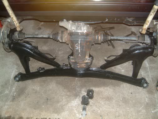

i did mine yesterday,
i used lots of hammers, fags and swearing!

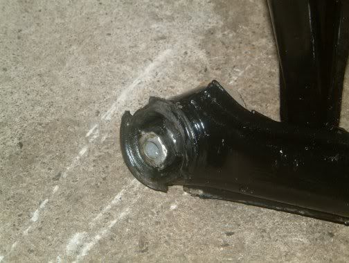

alright where abouts are you i done mine a couple of weeks ago but have the special tools and a ramp but if your near i could give u a hand had a bit of a problem doing mine as the metal sleeve snapped of in the dowl doh

I DID MINE A FEW MONTHS AGO. I USED A BLOW TORCH TO MELT THE OLD ONES OUT ,AND JUST HEATED THE FRAME ,UP PLENTY OF WASHING UP LIQUID AND USED THE WEIGHT OF THE CAR AN MY TROLLEY JACK TO PRESS THE NEW ONES IN. PERFECT. THE ONLY TROUBLE I HAD WAS THE ALLOY CENTER OF THE OLD BUSH HAD OXIDISED ITSELF TIGHT AND HAD TO SPEND AN HOUR WITH A LONG CHISEL KNOCKING IT FREE THROUGH THE HOLE UNDER THE REAR SEAT. STRESS!!!!!!!!!!!!!!!!!
GOOD LOOK AND MAKE SURE YOU NOTE THE NEW ONE GOES IN IN EXACTLY TH SAME PLACE AS THE OLD ONE, THEY HAVE A CERTAIN SHAPE TO THEM.

You could use Powerflex bushes, just burn/hack the old ones out and press (by hand) the Powerflex ones in... job done :cool:
Powerflex are in three parts, main bush, stainless tube and top bush and even comes with special lube.
I did this a while back, getting the old ones out is a pain but fitting is easy peasy :thumb:

Otherwise you can just drill the rubber out but it is tedious.
