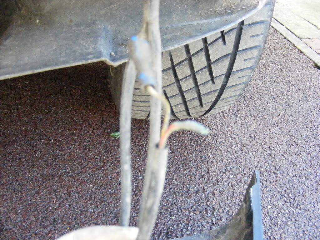

Temperature sensor all sorted but in the same area from the same loom was this wire which I'm not sure where it attached to. The wire colours are red/white and yellow/blue, I think (pretty dirty), any idea where they could plug into?

PG325 wrote:Temperature sensor all sorted but in the same area from the same loom was this wire which I'm not sure where it attached to. The wire colours are red/white and yellow/blue, I think (pretty dirty), any idea where they could plug into?
[img][img]http://i857.photobucket.com/albums/ab13 ... CF1551.jpg[/img][/img]
I'm still unsure about this extra wire but the OBC kit is all now fitted, doesn't it get a colder reading as the temp sensore is sat right at the front of the valance?
