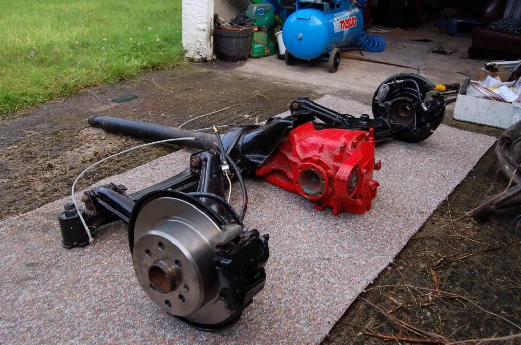

blasting would be preferred here as I did a bit of a DIY resto on my rear beam and trailing arms, but the wire brush can't get into the trailing arm mounting points properly, so you'll never clear all the rust out.
I then just used some cans of black smoothrite. It looks OK but isn't the same standard as blasting and powdercoating
