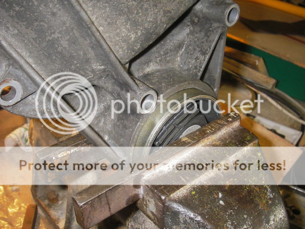

I think thats right. The z3 is an upgrade but not as easy to fit as a 2 piece polybush.tim_haynes wrote:sorry guys just one quick question,
what is the difference between the 325i diff bush and the z3 m? they both fit exactly the same? one is stronger?
- Posts: 22697
you have to be very careful with a vice as the back plate is only ali and it crack either rendering the backplate scrap!
A press to push the old and new ones is the proper way really.
ZM3 bush although is expensive is designed to keep 320bhp in check and is well up to the job

Diff bush in the freezer, backplate in the oven. Lay the backplate on a wide piece of flat wood, lay the bush in place, and tap it in SQUARE with another block of wood and a hammer.
