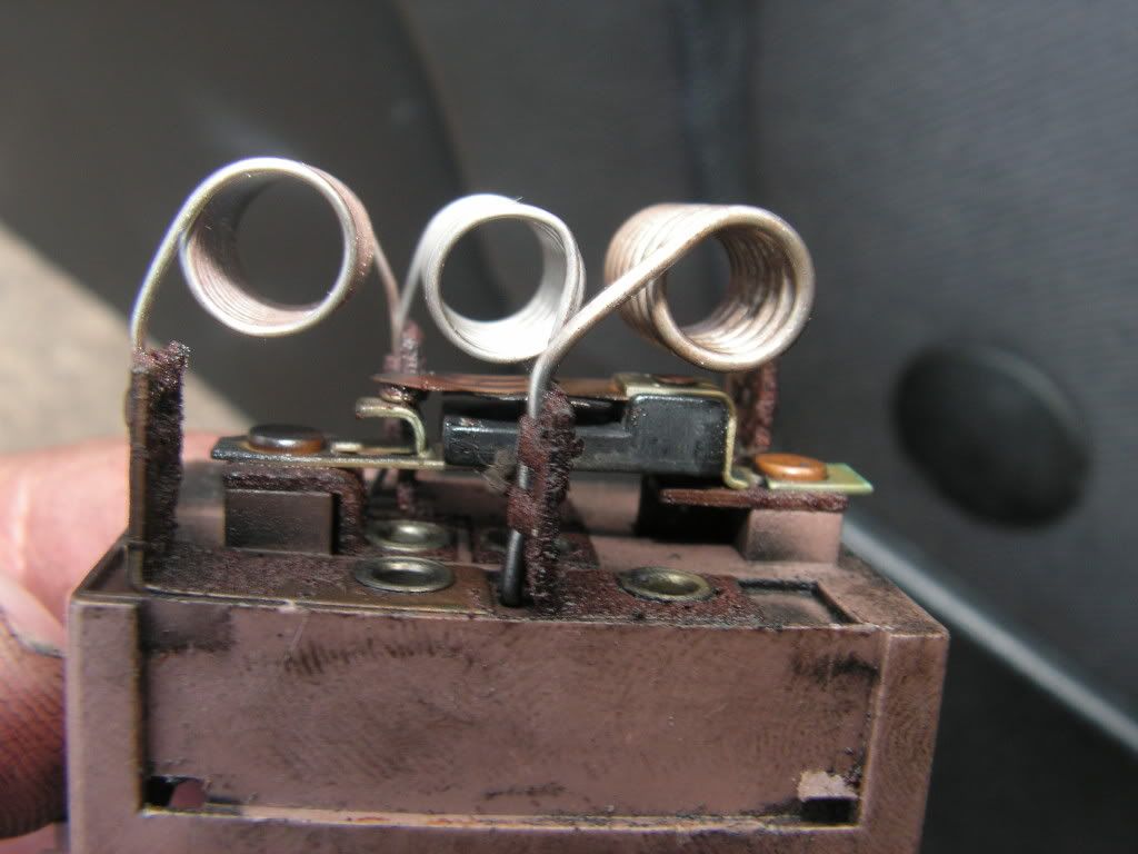

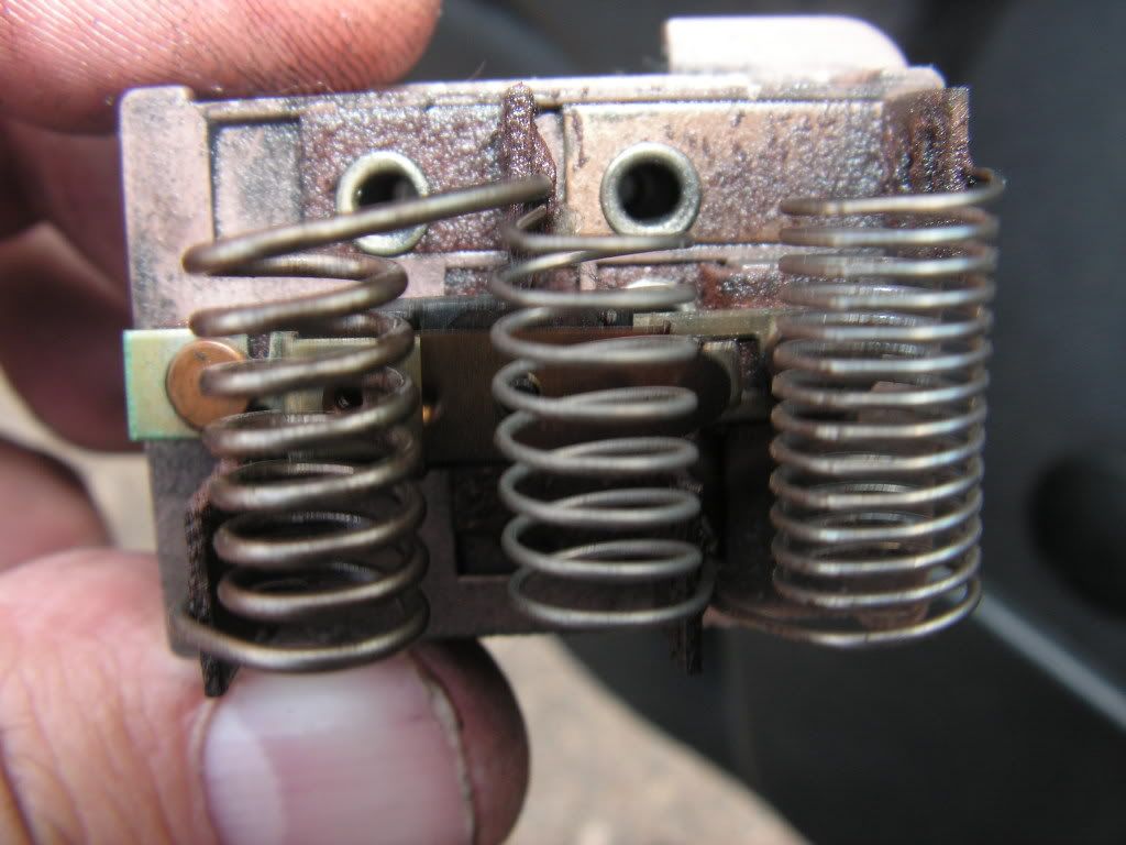

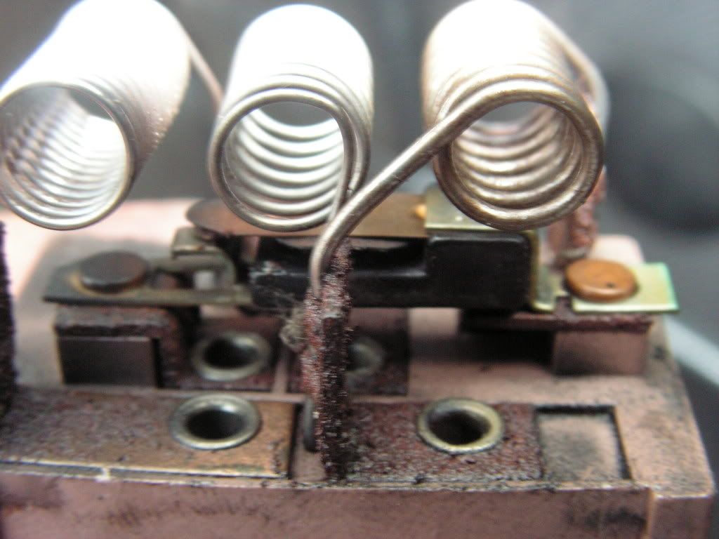

telboy
Posts: 68
Sun Jun 14, 2009 6:18 pm
ok took the brown clip out and this is what i found...i,m still none the wiser
[img][img]http://i124.photobucket.com/albums/p35/ ... tor010.jpg[/img][/img]
[img][img]http://i124.photobucket.com/albums/p35/ ... tor011.jpg[/img][/img]
[img][img]http://i124.photobucket.com/albums/p35/ ... tor008.jpg[/img][/img]
[img][img]http://i124.photobucket.com/albums/p35/ ... tor013.jpg[/img][/img]
[img][img]http://i124.photobucket.com/albums/p35/ ... tor007.jpg[/img][/img]
Brianmoooore
Posts: 49358
Tue Jun 16, 2009 12:03 am
First, there should be a steel cover over the resistors.
The thermal trip is the bit that runs across below the three resistors in your first two pics. The actual contacts are just below and to the left of the middle resistor in your second pic.
If the contacts are not actually making contact, the fan motor will not run on speeds 1, 2 or 3, or will repeatably trip and reset if the motor is drawing excess current.
The whole unit is bypassed on position 4, and the fan will operate the same on this setting, if the resistor pack is present or disconnected.
