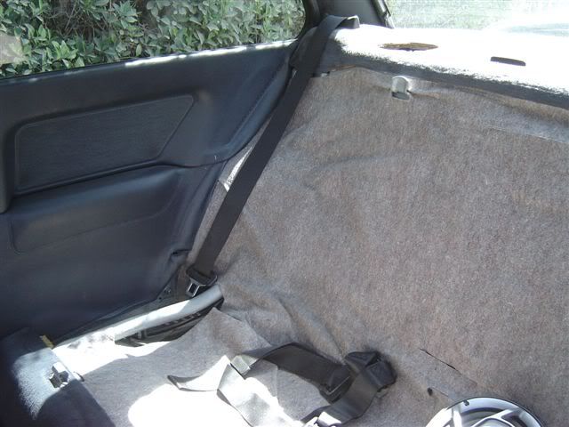

mrLEE30
Posts: 6589
Fri Apr 17, 2009 9:37 pm
if you look just next to the seat belt buckle you will see the fabric is peeled back, the bolt is just visible (i removed the bench obviously but replaced the bolt) once removed slide the rear seat back upwards - you can also see the upper mounts in the picture just below where the speaker hole is
