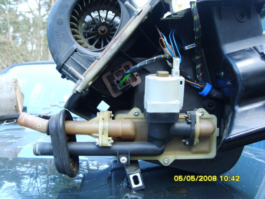

It looks like it's accesable from the pasenger side footwell, once the centre console has been removed.siddiqi1 wrote:the electric valve; where is this located Brian? Expensive part?
I'd post up a pic but imageshack is playing up at the mo

Electric valve is on the LH side of the heater box. Part of it is the black stub pipe that goes through into the engine compartment for the heater hose to connect to.

This is the plastic version
Complete assembly is for sale

Since we have a nice clear picture up on the thread; the matrix is the large rectangular white part behind the valve. Just slides out when the obvious bits are removed, although a few bits of brake bracket get in the way in the car.
The brown object with the wires, behind and to the left of the valve is the resistor pack for the fan.

i can see why its so difficult to get at all this stuff with it in situ; youd have to have small hands and minture tools! thanks baddave for all the help!

All I did was take a photo of an assembly I have ready to package up/ship to anyone who needs it

After having a look at my car today and the picture that is up i believe that it is the matrix that has gone. i got the car up to temp and had a good look at it and there seems to be a small crack in that rectangular part behind the pipes shown in the picture. Is there a gasket which goes on the matrix when you fit a new one?
